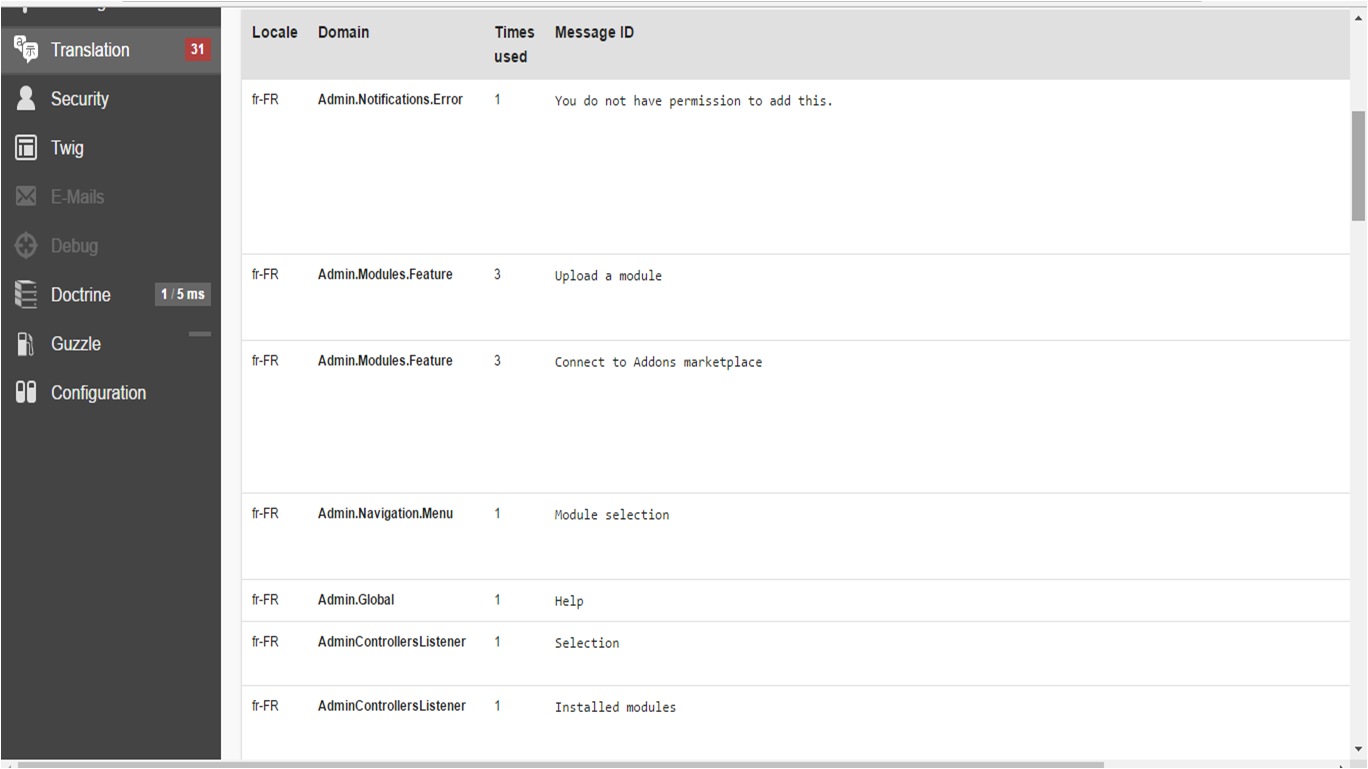

NabilR Posted June 6, 2017 Share Posted June 6, 2017 Hello I face a problem with my prestashop 1.7.1 I encounter Internal Server error 500 since I change the language to French. I see in log file that something wrong with missing translation (see screenshot) I am working in debug mode since then to avoid crash. Can someone help? I am not specialist for that Thanks Link to comment Share on other sites More sharing options...
Alex Even Posted June 7, 2017 Share Posted June 7, 2017 Hello, Please see this ticket and the last comment: http://forge.prestashop.com/browse/BOOM-2585 The "missing" translations shouldn't be the problem here. The translation are there in fact (interface is translated), it is simply that Symfony don't see it and shows this error. This will be fixed in version 1.7.2. Can you please open a Forge ticket telling us what you did before it crashed, besides adding the French language? did you made some other changes ? Unfortunately, I can't reproduce your issue. Thanks and regards, 1 Link to comment Share on other sites More sharing options...
