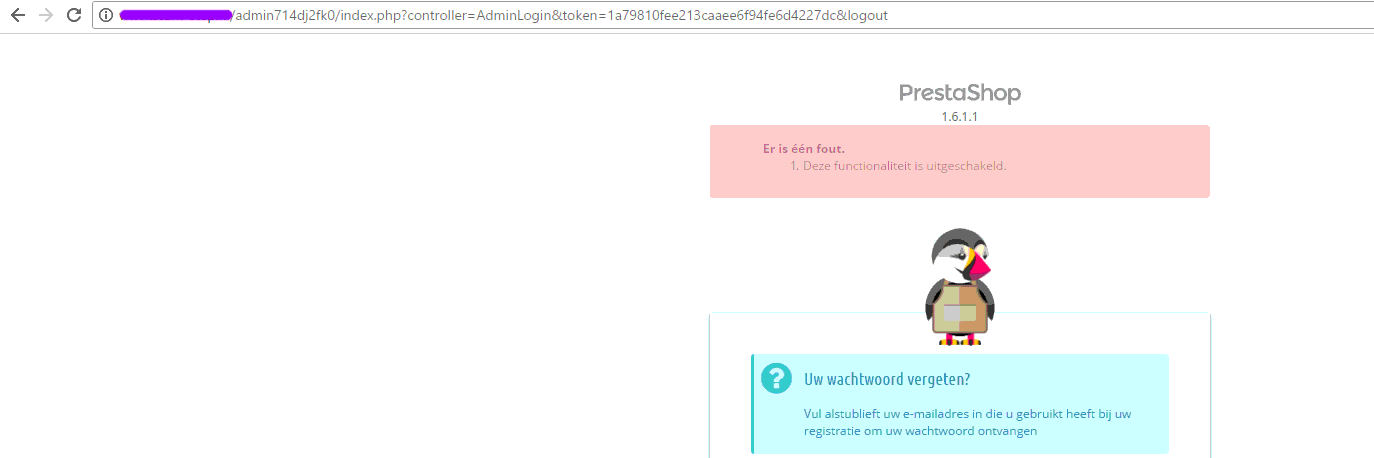

invpts3 Posted May 17, 2017 Author Share Posted May 17, 2017 Hi there, thanks for your reply. That's not possible. Even that is giving an error (see attachment). Just to be clear. It's possible to login in the backend. But when logged in as superadmin, big parts of the shop cannot be edited. Link to comment Share on other sites More sharing options...
