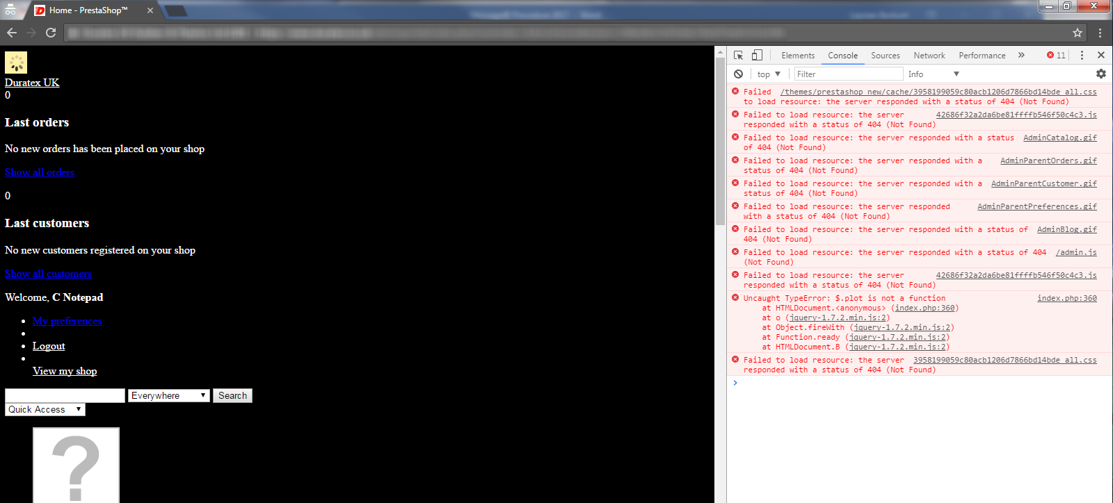

mowax Posted May 16, 2017 Share Posted May 16, 2017 Hi, I'm having a weird problem. My colleague who runs the shop has reported that the BO has suddenly stopped displaying the drop down menus properly. The menus are fully expanded, but none of the links work. Please see the screenshot attached. I can't reproduce the problem on my pc, it seems to be working fine. I have asked my colleague to clear browser cache and cookies, but the problem still persists. They have tested it over a mobile network connection and get the same problem. Does anyone recognise this problem? This has been going on since yesterday and is causing big problems for the business. Can anyone help please?? btw the ps version is 1.5.4.1 Link to comment Share on other sites More sharing options...

mowax Posted May 17, 2017 Author Share Posted May 17, 2017 (edited) I still can't replicate the issue but my colleague sent me a screenshoot of the error console, attached below lots of 404 errors it must be something weird happening on their server, because I get no errors when testing on my side. does anyone know what is causing this? Edited May 17, 2017 by mowax (see edit history) Link to comment Share on other sites More sharing options...
genweb Posted May 17, 2017 Share Posted May 17, 2017 That are a lot of 404 not found errors! Definitely that missing files are causing problems. You would need to debug that errors (you can ignore .gif files) Deactivate/delete Prestashop cache. If problem continues, you can hover over missing files in inspector an it will tell you where they should be located (you can go first for admin.js). After it, connect using FTP and check that files are there. If files are missing or corrupt, you should restore them from a clean copy. Link to comment Share on other sites More sharing options...
