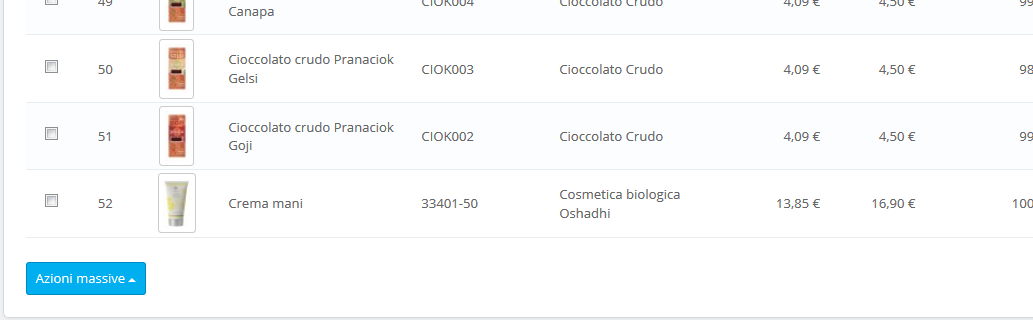

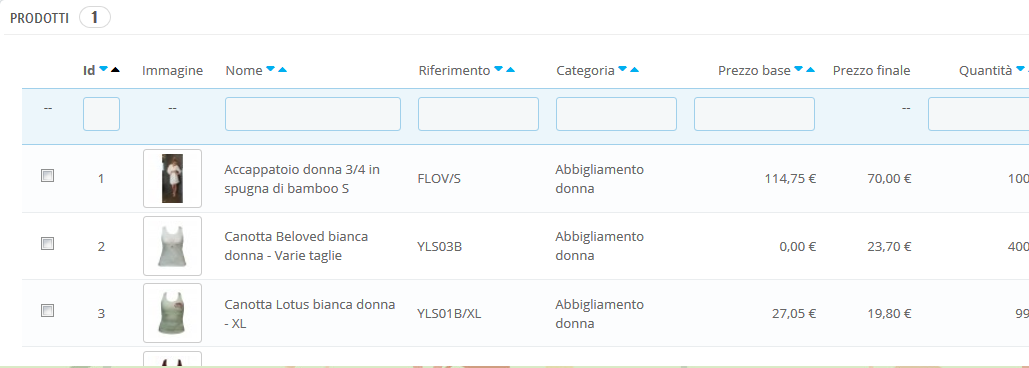

Valmiki108 Posted May 9, 2017 Share Posted May 9, 2017 Dear All, I have been using prestashop 1.6.1.4 for a year now. I had some problems in the past but was always able to find the solution. Today after a week holiday I was told that something weird happen: in the product list in the BO there is no more pagination number, there are over 1000 so there should be at least 20 pages. Also the number of products is always 1. The only thing that I can think of is that 2 weeks ago I did some updates: they were core modules though but I can't remember which. I know that this doesn't help much but unfortunately is the only thing that I can remember. I tried looking around same or similar issues but all I found dind't help unfortunately. Anybody that bumped into this kind of problem and can help? Thank you in advance. Valmiki Link to comment Share on other sites More sharing options...
