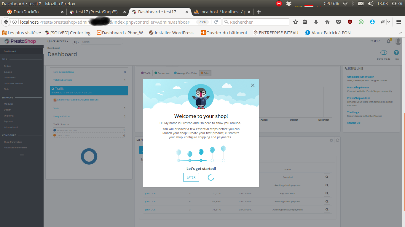

Gil_44 Posted May 5, 2017 Share Posted May 5, 2017 I run linux, and Xampp (Lampp- htdocs) and have installed locally PS 1.7.1.1 BUT Preston is blocking me now. One hour spent from now on the same page ->: www.transfernow.net/10amf1m09r9d Would s.o. have an idea? Maybe some other usual permission than the ones of the installation (config, add, logs...)??? Link to comment Share on other sites More sharing options...

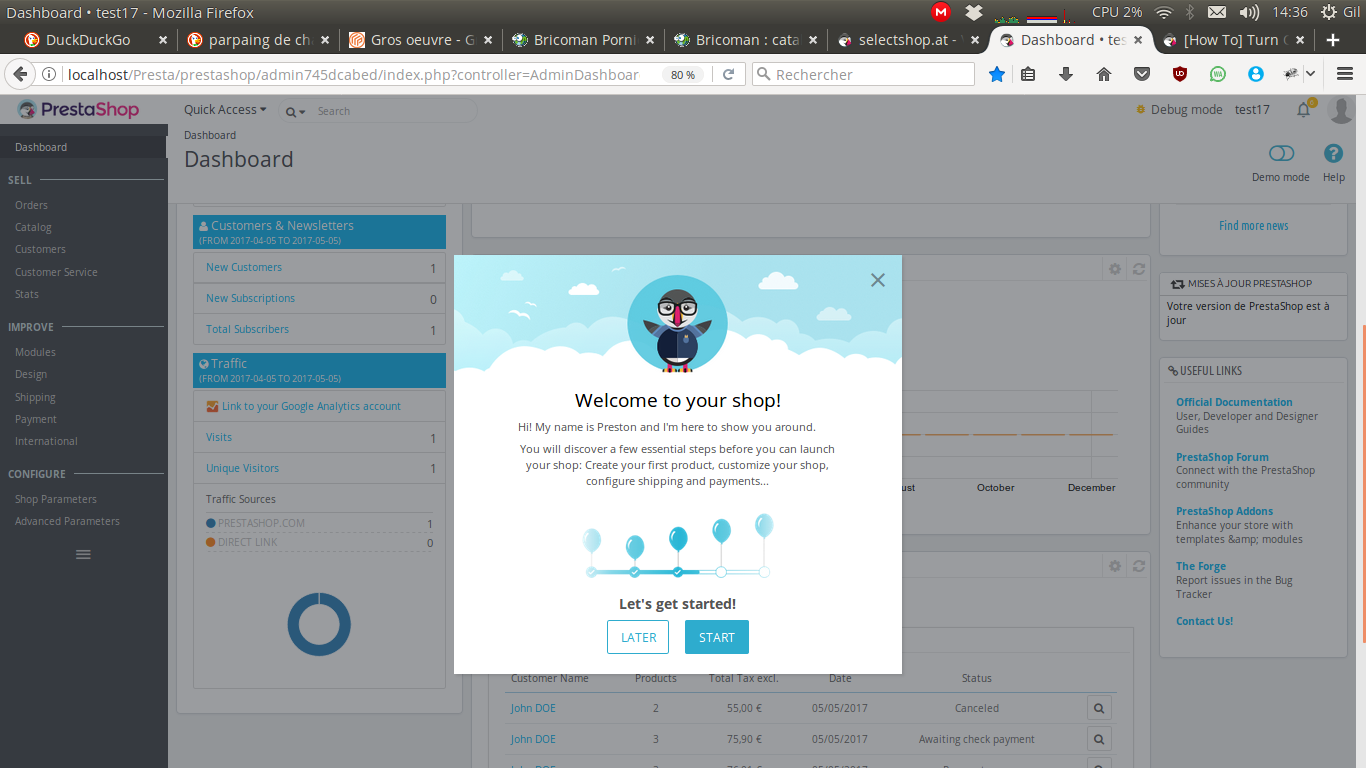

nadie Posted May 6, 2017 Share Posted May 6, 2017 This rename/remove module: "welcome" (Manually) and And check if you can navigate the panel Sorry for my English, Link to comment Share on other sites More sharing options...
Gil_44 Posted May 6, 2017 Author Share Posted May 6, 2017 Hi again Many thanks Nadie and selectshop.at. Renaming the `welcome` module-folder allows me to overcome the Preston blockage in the back office. Then-after, looking for the home page of the default theme in the front end, staying in the debug mode, I got this message: Fatal error: Uncaught exception 'Symfony\Component\Filesystem\Exception\IOException' with message 'Failed to create "/opt/lampp/htdocs/Presta/prestashop/themes/classic/assets/cache/": mkdir(): Permission denied.' in /opt/lampp/htdocs/Presta/prestashop/vendor/symfony/symfony/src/Symfony/Component/Filesystem/Filesystem.php:100 Stack trace: #0 /opt/lampp/htdocs/Presta/prestashop/classes/assets/CccReducer.php(45): Symfony\Component\Filesystem\Filesystem->mkdir('/opt/lampp/htdo...') #1 /opt/lampp/htdocs/Presta/prestashop/classes/controller/FrontController.php(213): CccReducerCore->__construct('/opt/lampp/htdo...', Object(PrestaShop\PrestaShop\Adapter\Configuration), Object(Symfony\Component\Filesystem\Filesystem)) #2 /opt/lampp/htdocs/Presta/prestashop/classes/controller/Controller.php(142): FrontControllerCore->__construct(false, false) #3 /opt/lampp/htdocs/Presta/prestashop/classes/Dispatcher.php(361): ControllerCore::getController('IndexController') #4 /opt/lampp/htdocs/Presta/prestashop/index.php(28): DispatcherCore->dispa in /opt/lampp/htdocs/Presta/prestashop/vendor/symfony/symfony/src/Symfony/Component/Filesystem/Filesystem.php on line 100 I then made a recursive chmod 777 (root@xxxx:/opt/lampp/htdocs/Presta/prestashop# chmod -R 777 themes) on the 'theme' folder that allows me partially to resolve the display. I got finally the entire site, back and front end fully working 'chmoding' 777 on the entire prestashop folder: $ root@xxxxx: /opt/lampp/htdocs/Presta# chmod -R 777 prestashop (I will add a screen shot at the end). It is not the best secure way for an on-line configuration but that will allow me work on the home-page, build some cms pages and test modules, locally. PS: I changed no ssl permission. Thanks a lot! A good WE ! Gil Link to comment Share on other sites More sharing options...

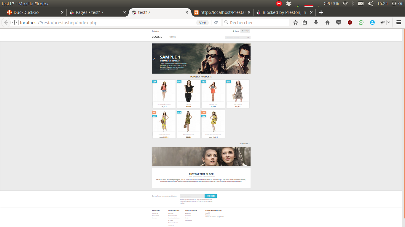

Gil_44 Posted May 6, 2017 Author Share Posted May 6, 2017 here the site locally working with full permission on the prestashop folder www.transfernow.net/9126k016o52s Link to comment Share on other sites More sharing options...
Gil_44 Posted May 6, 2017 Author Share Posted May 6, 2017 The same screen shot of prestashop working locally with the full permission as an attached file ( sorry, I am very new on this forum) Link to comment Share on other sites More sharing options...
selectshop.at Posted May 6, 2017 Share Posted May 6, 2017 Deactivate filecaching. Your XAMPP is not configured for to use caching, not this type. Back-Office Section "configure": advanced parameters -> performance- > Smarty section: CACHE = NO. This is not the correct configuration you should use on live servers, but it should solve the problem of your bad configured Xampp. For to avoid such lousy errors, it is better you move to live server Link to comment Share on other sites More sharing options...
