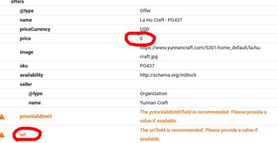

Zeryk Posted February 11, 2020 Share Posted February 11, 2020 (edited) PS 1.6.1.23 thanks for one step forward , yet few are still ahead. solution works on product list, but in product it self shows / reads the price value "0" for some reason? Should I also edit product.tpl ( as it's recommended for 1.7 version ) Also other fields like url . , is there any tutorial / general solution for all that , or has to be done bit by bit from info sourced from different websites or programmers? Thanks for your support! Edited February 11, 2020 by Zeryk (see edit history) Link to comment Share on other sites More sharing options...
