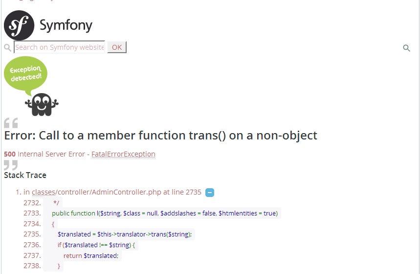

I installed the latest release of PS and all works fine except on the products section. When i try to insert a new product and set title and i try to insert an image, the (enabling the debug mode) i get the error reported on the attached file. Also, on my apache error log i get the following: PHP Fatal error:  Call to a member function trans() on a non-object in /mysite_root/classes/controller/AdminController.php on line 2735 and this is the interested funcion:

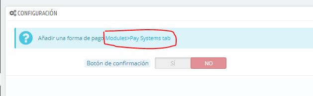

Hi @musicmaster, I use PS 1.7.3.0 and installed UniversalPay V3.0.0.
First when I click on Pay Systems tab
I get error 500, this is PHP error:

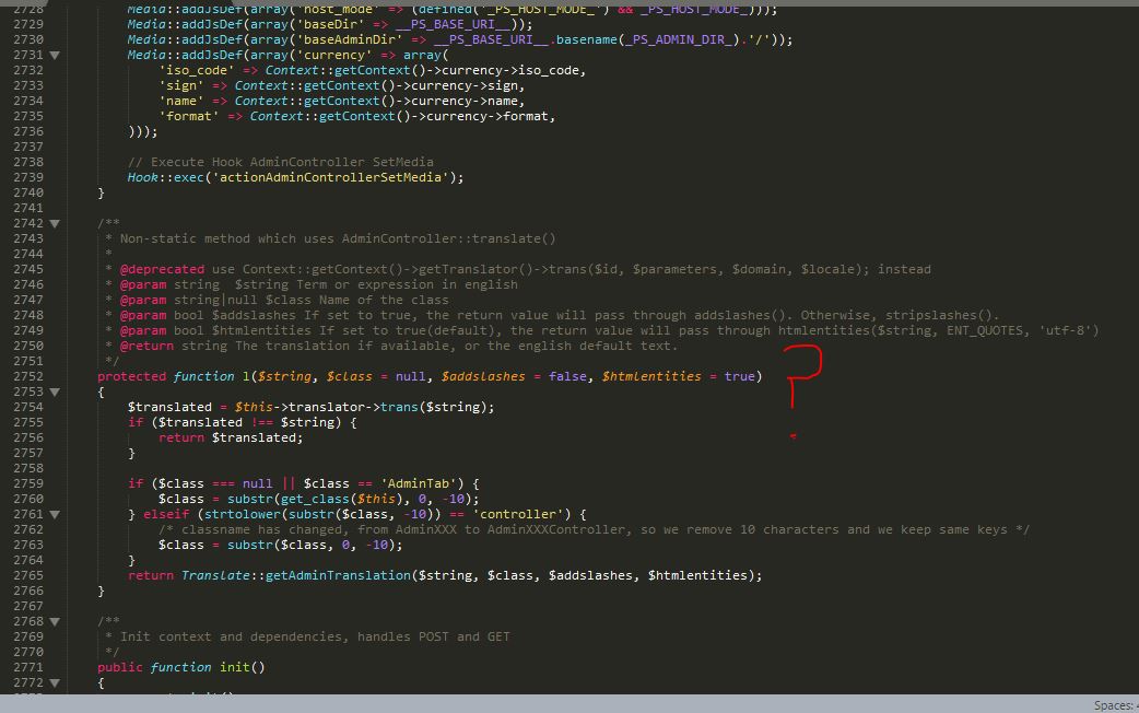

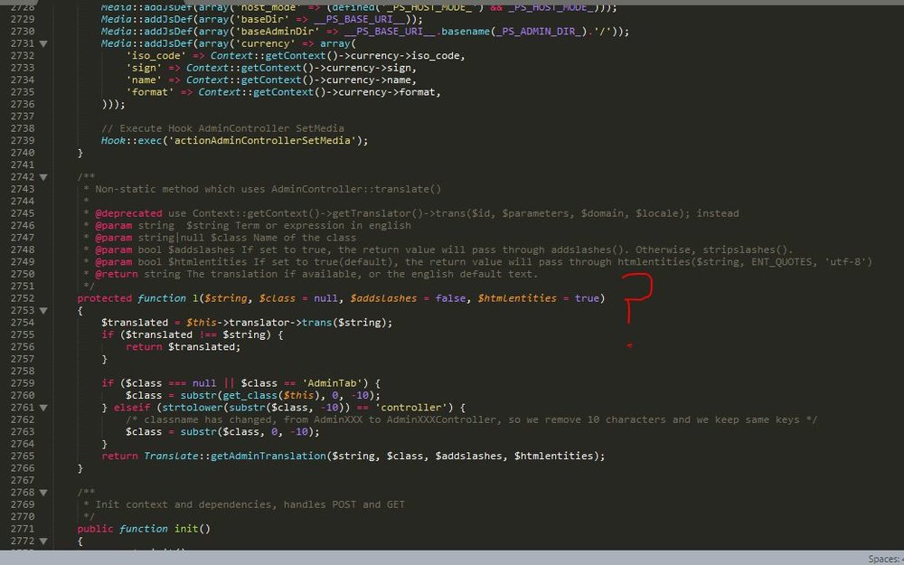

Fatal error: Call to a member function trans () on null in ...... / classes / controller / AdminController.php on line 2754
Then I made a change in  .../classes/controller/AdminController.php
edited the line $translated = $this->translator->trans($string);
to
$ translated = Context :: getContext () -> getTranslator () -> trans ($ string);
As the message said back and error 500 was solved.

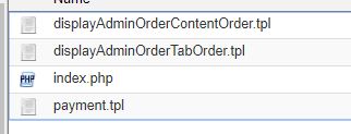

this is the content of the folder ../modules/universalpay/views/templates/front
this is the content of the folder ../modules/universalpay/views/templates/hook
Please if you need more info :) thanks
