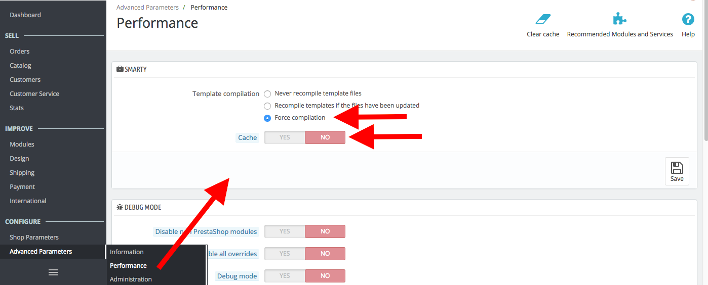

Andrej Stas Posted June 7, 2017 Share Posted June 7, 2017 I'm not sure if this will work, but it is worth giving it a try: https://www.prestashop.com/forums/topic/613058-error-upgrading-from-1702-to-1711-with-one-click-upgrade/ The basic idea is that you should turn off cache and turn on "force compilation" in the "Advanced Parameters" before upgrading. Link to comment Share on other sites More sharing options...
Vicente Paul Posted June 7, 2017 Author Share Posted June 7, 2017 I'm not sure if this will work, but it is worth giving it a try: https://www.prestashop.com/forums/topic/613058-error-upgrading-from-1702-to-1711-with-one-click-upgrade/ The basic idea is that you should turn off cache and turn on "force compilation" in the "Advanced Parameters" before upgrading. Thanks for trying to solve the problem Andrej, but I had already done that... I guess the 1-click module even don´t see the diference between PS 1.7.1.0 and 1.7.1.1, and so does nothing. What I will try is the following: as the PS 1.7.1.2 is going to be released now, I will do a last try... If it doesn´t work (after doing full directories and DB backups), I will reinstall PS 1.7.1.2 from scratch, copy back the images (and small modifications I made in .css and .php), and do a full restore of the previous PS 1.7.1.0 database to recover all my work, as a guess the database didn´t change between PS 1.7.1.0 and 1.7.1.2... What do you think about that? Link to comment Share on other sites More sharing options...

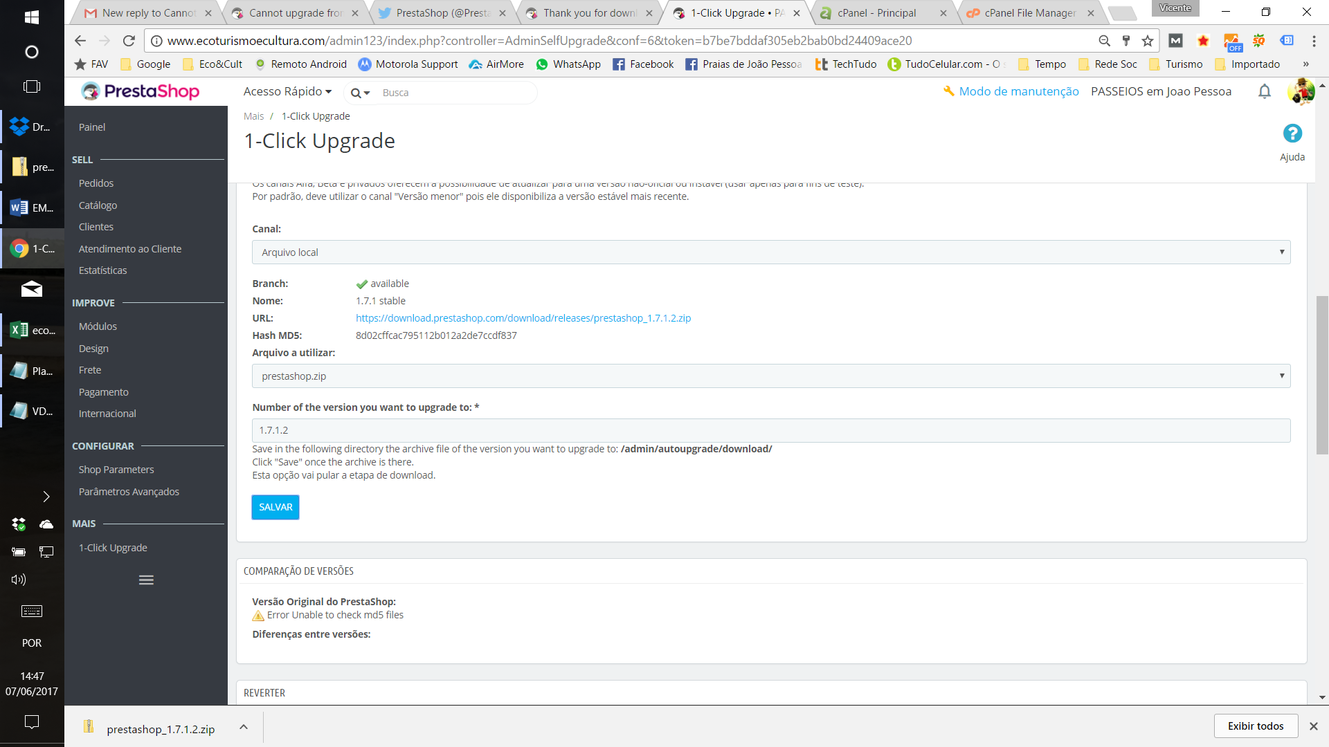

Vicente Paul Posted June 7, 2017 Author Share Posted June 7, 2017 ...even manually with prestashop.zip into adminxxx/autoupgrade/download/ Link to comment Share on other sites More sharing options...
Faoz Posted June 7, 2017 Share Posted June 7, 2017 Yes yes the manually upgrade also not working. It seems so that the auto updater is completly corrupt. Link to comment Share on other sites More sharing options...
Vicente Paul Posted June 7, 2017 Author Share Posted June 7, 2017 (edited) Yes that updater seems corrupt, so I tried the latest test version of the updater, and it´s even worse!: - it doesn´t know about the 1.7.1.2 (just know about the the previous 1.7.1.1 version); - in manual mode, it even doesn´t find the .zip file which is there; Really painfull! Edited June 7, 2017 by Vicente Paul (see edit history) Link to comment Share on other sites More sharing options...
