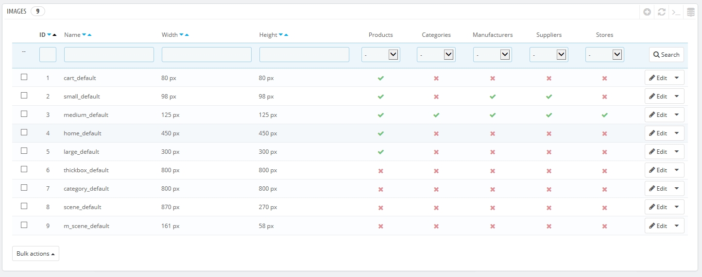

Daresh Posted April 26, 2017 Share Posted April 26, 2017 Hard to help without seeing some example images and at least a screenshot from the Images preferences. Link to comment Share on other sites More sharing options...

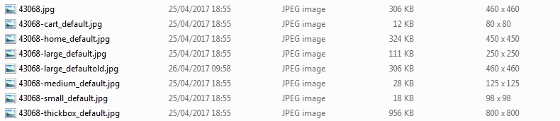

msward Posted April 26, 2017 Author Share Posted April 26, 2017 Sorry, should have attached these files.The website is www.262sportsphotography.com/shopClick on Run2017 Brighton MarathonYou will see the picture of the 2 guys in yellow tops, this is the one I have been using to do the testing, the original image I am using is 460 x 460, in the image settings I have large_default set to 250 x 250, looking at the image url, this is the correct image for the main product picture on the products page but it creates one of 460 x 460 despite the setting and displays it as you will see at 460 x 460 not 250 x 250Its rotated at the moment as I was testing to make sure what I was changing was actually being changed, the image is actually square with a white border, this allow me to have all images square and initially 460 x 460.Any help much appreciated Link to comment Share on other sites More sharing options...
msward Posted April 27, 2017 Author Share Posted April 27, 2017 Well I got somewhere, I forgot to say that I import my product using Prestashop Manager, I decided to go directly in Presashop and delete one and add it directly and ti came in perfectly and indeed did not create the 800 x 800 image that I had deleted.It appears the problem was with Prestashop manager, I reboots and reloaded it, did a re-sync and it now creates the correct images at the correct size but still having a couple of issues.1. The images it creates are MUCH bigger in size than the Prestashop ones but don't look any different, example the product image is 400 x 400 and Prestashop one is 32kb, the Manager one is 88kb, nearly 3 times the size.2. Even though it creates a 400 x400 product image, it then displays in the shop at 460 x 460 whereas the one directly created in Prestashop creates 400 x 400 and displays 400 x 400 ?Weird !, I cant find anywhere that each image has its own display settings so assume the page just uses the settings in the image config file ? Link to comment Share on other sites More sharing options...
