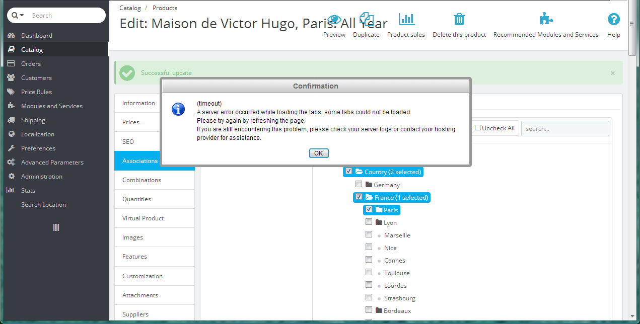

Divento123 Posted April 24, 2017 Share Posted April 24, 2017 Hello, We have a problem on our Prestashop platform. Every time we try to save a product with a lot of combinations, the page times out. Can it be correlated? If so, how could we increase the response time on Prestashop back-office? (Prestashop 1.6.1.11) Thanks a lot Link to comment Share on other sites More sharing options...

Divento123 Posted April 25, 2017 Author Share Posted April 25, 2017 Hi, Thanks for your answer and your suggestions. We checked all of your suggestions and we were not able to solve the problem. After further investigation, we found that this is not a server problem as you suggested, but a Prestashop problem. Our web developer modified a file on the server (js/admin/products.js at line 124 there was "timeout: 30000"), which has solved the time out problem. Now we can more or less save a product, but it takes so much time to do so that our back-office in unusable. What do you suggest? Link to comment Share on other sites More sharing options...
