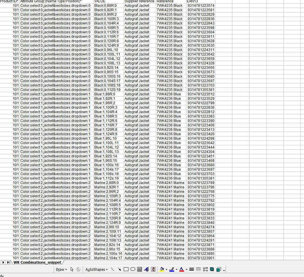

admin@wolfkanat Posted April 11, 2017 Author Share Posted April 11, 2017 Your heading line's missing the Value field: Product ID*;Attribute (Name:Type:Position)*;Value (Value:Position)*;... You need some commas to separate attribute and value combinations: 101;Color:select:0, jacket&vestsizes:dropdown:0;Black:0, 88R:0;Autograf Jacket;7WK4235 Black ;9314781223574;;3;3;;0 Ok so i have checked and had various (a lot) of attempts at getting the csv to upload correctly! The issue seems to be - Where there is a product that has multiple colours and sizes, the colours are visible, however only one size option shows instead of the correct size range. It creates the sizes in the attributes, but when you look at the product combination the sizes are not there... Any ideas anyone ? Does anyone have a fashion CSV that has products with multiple colours and sizes / eans? that i can look at as an example? I've uploaded a snippet of mine - which shows the main content area - HELP!! thanks Giulia Link to comment Share on other sites More sharing options...
JeredBolton Posted April 11, 2017 Share Posted April 11, 2017 Change dropdown to select. The types available are: select for drop-down menus, radio for radio buttons color for color boxes Link to comment Share on other sites More sharing options...
admin@wolfkanat Posted April 12, 2017 Author Share Posted April 12, 2017 thanks jared - Still not working even with the above change. Its also re writing the size attribute groups, and added a second file of the same group. these are some of the lines - just so your aware i'm using , as the field separator and the ; as the multiple value - Product ID*,Attribute Group:(Name:Type:Position)*,Value:Position,Supplier reference,Reference,EAN13,Quantity,Minimal quantity,Default (0 = No; 1 = Yes) 101,Colour:colour:1;Jacket & Vest Sizes:select:12,Black:1;100L:12,Autograf Jacket,7WK4235 Black ,9314781223642,3,3,0 101,Colour:colour:1;Jacket & Vest Sizes:select:4,Black:1;100R:4,Autograf Jacket,7WK4235 Black ,9314781222836,3,3,0 101,Colour:colour:1;Jacket & Vest Sizes:select:17,Black:1;100S:17,Autograf Jacket,7WK4235 Black ,9314781223680,3,3,0 101,Colour:colour:1;Jacket & Vest Sizes:select:13,Black:1;104L:13,Autograf Jacket,7WK4235 Black ,9314781223659,3,3,0 101,Colour:colour:1;Jacket & Vest Sizes:select:5,Black:1;104R:5,Autograf Jacket,7WK4235 Black ,9314781222843,3,3,0 I have tried a few variations but still - its like something is overriding it as only one size of each colour comes up visible. any other suggestions? i'm not sure what to try next! I really don't want to manually set the products up as its hundreds of lines! thanks Giulia Link to comment Share on other sites More sharing options...
JeredBolton Posted April 12, 2017 Share Posted April 12, 2017 Here's a version of your sample that I've extended to include another colour: Product ID*,Attribute Group:(Name:Type:Position)*,Value:Position,Supplier reference,Reference,EAN13,Quantity,Minimal quantity,Default (0 = No; 1 = Yes)8, Color:color:0; Jacket & Vest Sizes:select:1, Black:0;100L:1,Autograf Jacket,7WK4235 Black ,9314781223642,3,3,08, Color:color:0; Jacket & Vest Sizes:select:1, Black:0;100R:1,Autograf Jacket,7WK4236 Black ,9314781222836,3,3,08, Color:color:0; Jacket & Vest Sizes:select:1, Black:0;100S:1,Autograf Jacket,7WK4237 Black ,9314781223680,3,3,08, Color:color:0; Jacket & Vest Sizes:select:1, Black:0;104L:1,Autograf Jacket,7WK4238 Black ,9314781223659,3,3,08, Color:color:0; Jacket & Vest Sizes:select:1, Black:0;104R:1,Autograf Jacket,7WK4239 Black ,9314781222843,3,3,08, Color:color:1; Jacket & Vest Sizes:select:1, Pink:1;100L:1,Autograf Jacket,7WK5235 Pink ,8314781223642,3,3,08, Color:color:1; Jacket & Vest Sizes:select:1, Pink:1;100R:1,Autograf Jacket,7WK5236 Pink ,8314781222836,3,3,08, Color:color:1; Jacket & Vest Sizes:select:1, Pink:1;100S:1,Autograf Jacket,7WK5237 Pink ,8314781223680,3,3,08, Color:color:1; Jacket & Vest Sizes:select:1, Pink:1;104L:1,Autograf Jacket,7WK5238 Pink ,8314781223659,3,3,08, Color:color:1; Jacket & Vest Sizes:select:1, Pink:1;104R:1,Autograf Jacket,7WK5239 Pink ,8314781222843,3,3,0 A few observations: You have to spell color the American (incorrect) way, otherwise prestashop doesn't pick up the off-the-shelf Color Attributes.You could create your own Product Attributes called Colour and define each colour yourself, but it makes sense to pick up the existing ones. I've kept the Position value simple, 0 or 1. I've made the Reference unique. In your example all combinations have the same reference (7WK4235 Black) which is why you're only getting one of each colour group. Link to comment Share on other sites More sharing options...

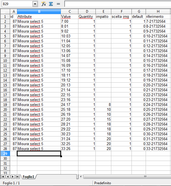

c.cristinziano Posted March 5, 2019 Share Posted March 5, 2019 Hi, Im trying to set up the ring size for my products on prestashop, and you can see how I've set the csv file attached, For you where is the issue? Thank you very much Link to comment Share on other sites More sharing options...
