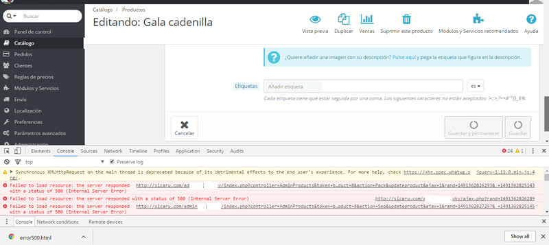

I'm getting the same error.
I updated 1.7.0.4> 1.7.1.0. The product is not added after the update.
