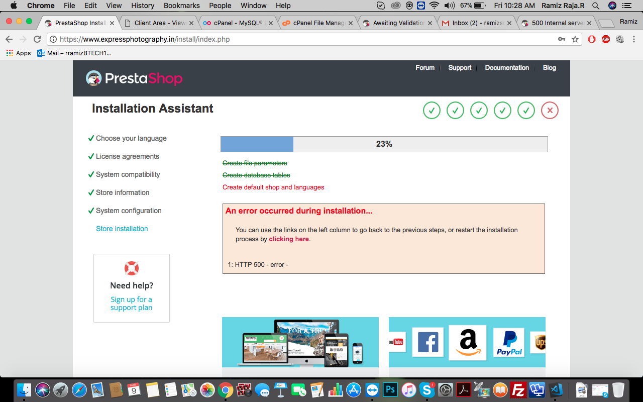

Ramiz Raja Posted March 9, 2018 Share Posted March 9, 2018 : HTTP 500 - error - I am getting this error while installing Prestashop 1.7.3 please help me 1 Link to comment Share on other sites More sharing options...
francesc Posted March 10, 2018 Share Posted March 10, 2018 On 9/3/2018 at 6:01 AM, Ramiz Raja said: : HTTP 500 - error - I am getting this error while installing Prestashop 1.7.3 please help me I have the same problem and it is not resolved by changing index.php permissions ! :'( 1 Link to comment Share on other sites More sharing options...
LineCP Posted March 10, 2018 Share Posted March 10, 2018 Dear francesc Try to Install without to change the installation language (English). That's works for me. Christos 1 Link to comment Share on other sites More sharing options...
francesc Posted March 12, 2018 Share Posted March 12, 2018 Thanks, but does the same Link to comment Share on other sites More sharing options...
francesc Posted March 12, 2018 Share Posted March 12, 2018 Resolved! I reloaded all the files and the installation no longer fails me, I think some would be corrupted by a bad upload Link to comment Share on other sites More sharing options...

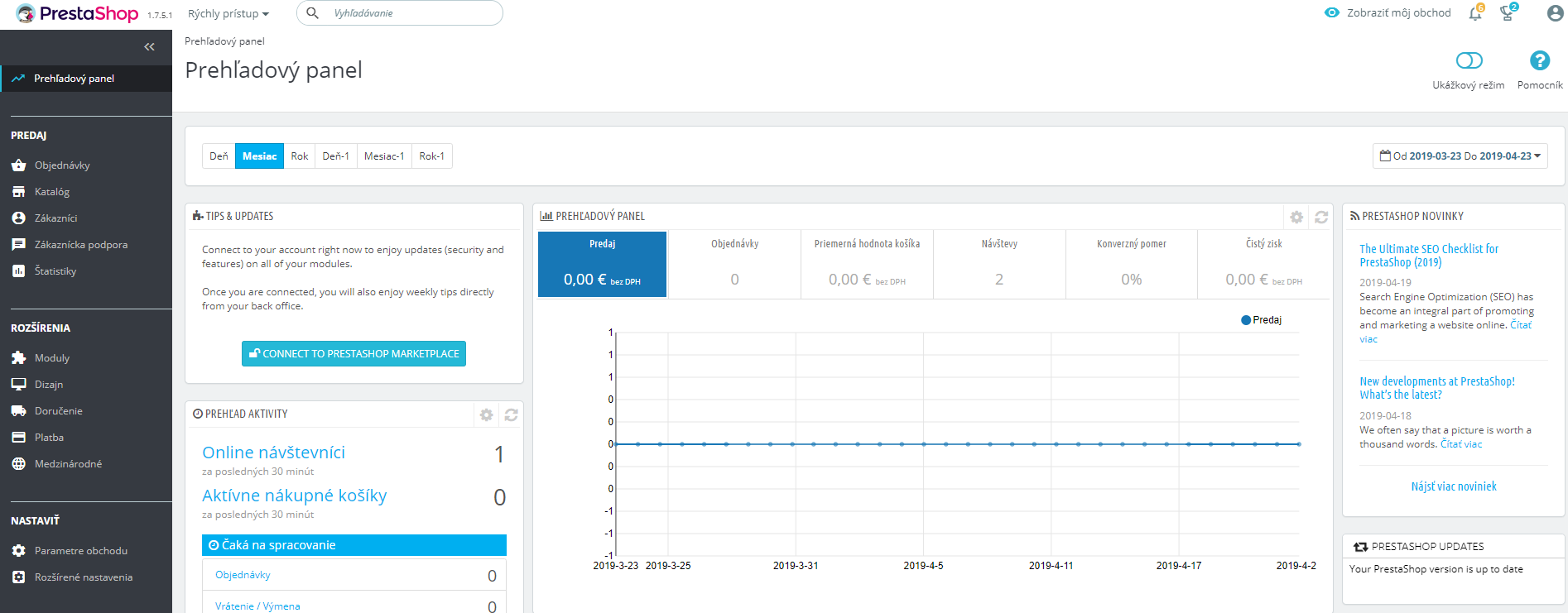

JB79 Posted April 25, 2019 Share Posted April 25, 2019 Same problem... HTTP 500 error... Nothing has worked for me. But I have found solution. Problem is on hosting server PHP version. Here is a table where are official PHP requirements, but it's really not correct for a new installation of prestashop, not sure for update od PS. PrestaShop Version Minimum Recommended Not compatible 1.6.1.x PHP 5.2 PHP 7.1 PHP 7.2+ 1.7.0 ~ 1.7.3 PHP 5.4 PHP 7.1 PHP 7.2+ 1.7.4 PHP 5.6 PHP 7.1 PHP 7.2+ 1.7.5 PHP 5.6 PHP 7.2 PHP 7.3+ I have tried many solutions (language change, permission change, but nothing has worked for me). So as a last thing I have tried was PHP ver. change from 5.6 to 7.2 and then everything was installed correctly with no errors in Slovak langauge (Prestashop v 1.7.5.1). I have tested PHP versions 7.0 and 7.1, but there was an errors too. So the solution for me was to change hosting server PHP to ver. 7.2 and everything is fine now for me now. Link to comment Share on other sites More sharing options...
thehurricane Posted November 15, 2019 Share Posted November 15, 2019 On 4/25/2019 at 11:03 AM, JB79 said: Same problem... HTTP 500 error... Nothing has worked for me. But I have found solution. Problem is on hosting server PHP version. Here is a table where are official PHP requirements, but it's really not correct for a new installation of prestashop, not sure for update od PS. PrestaShop Version Minimum Recommended Not compatible 1.6.1.x PHP 5.2 PHP 7.1 PHP 7.2+ 1.7.0 ~ 1.7.3 PHP 5.4 PHP 7.1 PHP 7.2+ 1.7.4 PHP 5.6 PHP 7.1 PHP 7.2+ 1.7.5 PHP 5.6 PHP 7.2 PHP 7.3+ I have tried many solutions (language change, permission change, but nothing has worked for me). So as a last thing I have tried was PHP ver. change from 5.6 to 7.2 and then everything was installed correctly with no errors in Slovak langauge (Prestashop v 1.7.5.1). I have tested PHP versions 7.0 and 7.1, but there was an errors too. So the solution for me was to change hosting server PHP to ver. 7.2 and everything is fine now for me now. For me solution was the same, just changed PHP version to 7.2 Link to comment Share on other sites More sharing options...

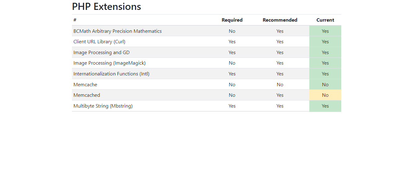

Irualz Posted September 23, 2021 Share Posted September 23, 2021 Thanks for the tip. I ran the PHP info system requirements tool and everything else is ok except for max_input_vars under PHP configuration (current 1000, recommended 5000) memcached under PHP extensions (No vs. Yes) My PHP version is 7.4.23 and recommended is 7.1 but that shouldn't have effect I believe? Link to comment Share on other sites More sharing options...
Irualz Posted September 27, 2021 Share Posted September 27, 2021 On 9/23/2021 at 9:47 PM, Irualz said: Thanks for the tip. I ran the PHP info system requirements tool and everything else is ok except for max_input_vars under PHP configuration (current 1000, recommended 5000) memcached under PHP extensions (No vs. Yes) My PHP version is 7.4.23 and recommended is 7.1 but that shouldn't have effect I believe? Should there be an error log or such in my bluehost server? I really have no idea how to go forward from here. Should I maybe try some earlier PrestaShop versions instead of 1.7.7.8? Link to comment Share on other sites More sharing options...
Nickz Posted September 27, 2021 Share Posted September 27, 2021 4 hours ago, Irualz said: My PHP version is 7.4.23 and recommended is 7.1 but that shouldn't have effect I believe? Try it. Bluehost is not the best choice for a business startup. Specially when shared server. PHP uploads you change in php.ini for the version your server runs on. Link to comment Share on other sites More sharing options...
