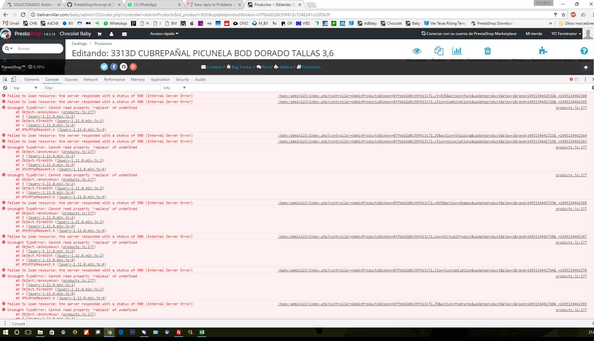

Therminator Posted May 18, 2017 Share Posted May 18, 2017 No consigo introducir la captura de pantalla, pero te copio todo lo que sale en la Console, gracias. /baby/admin123/index.php?controller=AdminProducts&token=07fbbd2d0c59f413c72…ction=Associations&updateproduct&ajax=1&rand=1495117229653&_=1495117229261 Failed to load resource: the server responded with a status of 500 (Internal Server Error) /baby/admin123/index.php?controller=AdminProducts&token=07fbbd2d0c59f413c72…35&action=Shipping&updateproduct&ajax=1&rand=1495117229662&_=1495117229262 Failed to load resource: the server responded with a status of 500 (Internal Server Error) products.js:177 Uncaught TypeError: Cannot read property 'replace' of undefined at Object.<anonymous> (products.js:177) at j (jquery-1.11.0.min.js:2) at Object.fireWith (jquery-1.11.0.min.js:2) at x (jquery-1.11.0.min.js:4) at XMLHttpRequest.b (jquery-1.11.0.min.js:4) products.js:177 Uncaught TypeError: Cannot read property 'replace' of undefined at Object.<anonymous> (products.js:177) at j (jquery-1.11.0.min.js:2) at Object.fireWith (jquery-1.11.0.min.js:2) at x (jquery-1.11.0.min.js:4) at XMLHttpRequest.b (jquery-1.11.0.min.js:4) /baby/admin123/index.php?controller=AdminProducts&token=07fbbd2d0c59f413c72…ion=VirtualProduct&updateproduct&ajax=1&rand=1495117230752&_=1495117229265 Failed to load resource: the server responded with a status of 500 (Internal Server Error) products.js:177 Uncaught TypeError: Cannot read property 'replace' of undefined at Object.<anonymous> (products.js:177) at j (jquery-1.11.0.min.js:2) at Object.fireWith (jquery-1.11.0.min.js:2) at x (jquery-1.11.0.min.js:4) at XMLHttpRequest.b (jquery-1.11.0.min.js:4) Link to comment Share on other sites More sharing options...

LieBM Posted May 18, 2017 Share Posted May 18, 2017 Hola Lie Bosch, gracias, pero siguen dando vueltas no se ha solucionado, empezaron a dar vueltas antes de actualizarme, por eso me actualice, y no active ni instale ningún modulo, ademas siguen saliendo errores ahora tengo 17. Sin-título-1.jpg Viendo estos detalles que me cuentas y las imágenes y que has actualizado ya dos veces y sigue apareciendo lo mismo.... Tú estás teniendo un problema con tu servidor (con esos errores de código 500) y concretamente con la versión de PHP que utiliza tu servidor. Pídele a tu proveedor de hosting que te cambie de versión de php a una superior (por ejemplo la 5.6) o al menos que te cambie a una versión diferente que la que tienes ahora para hacer las pruebas. En cuanto ocurra, mira a ver que pasa, creo que la solución está ahí. Depende incluso del panel de tu hosting, es posible que tu puedas hacer el cambio de la versión de php en la opción de php que debe de llevar el panel de hosting. Si no se te soluciona con esto último que te digo, ya desde la distancia y sin posibilidad de ver más cosas no puedo ayudarte más. Lo siguiente sería lo que te comenté en el mensaje anterior, meterme yo dentro de tu sistema y empezar a hacer test y ver los log de errores de tu servidor, etc.. para dar con el problema, pero eso ya no puede ser soporte gratuito de foro. Saludos y ya nos cuentas si es esto último que te digo y si lo has podido solucionar. 1 Link to comment Share on other sites More sharing options...
