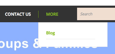

ricop Posted March 21, 2017 Share Posted March 21, 2017 Hope someone can help. I cannot remove "Blog" menu item from Top Horizontal Menu (PS1.6.1.11), it is not showing as an item under Top Horizontal Menu module configuration, so cannot remove this way. I think it was part of the sample content on install. The link from the Blog menu item goes to www.thedomainname.com/smartblog.html and 404 error this page cannot be found! Be very good to be able to delete this from my main menu bar Link to comment Share on other sites More sharing options...

FanieLumia Posted May 7, 2017 Share Posted May 7, 2017 Never mind I found the solution. You need to remove a piece of code from the blocktopmemnu.tpl (theme/'yourtheme'/modules/blocktopmenu/blocktopmenu.tpl), then it will disappear. This part: {if Module::isInstalled("smartblog") && Module::isInstalled("smartbloghomelatestnews") && (Module::isEnabled("smartblog")) && (Module::isEnabled("smartbloghomelatestnews"))} <li class="ttblog"> <a title="Blog" href="{$base_dir}smartblog.html">Blog</a> </li> {/if} Hope it helps someone else! Link to comment Share on other sites More sharing options...
vekia Posted May 8, 2017 Share Posted May 8, 2017 i thnk that it depends on theme because default one does not have a smartblog, so i think that this is not an universal way to remove the url. what theme you use? it is worth to mention it. Link to comment Share on other sites More sharing options...
FanieLumia Posted May 9, 2017 Share Posted May 9, 2017 i thnk that it depends on theme because default one does not have a smartblog, so i think that this is not an universal way to remove the url. what theme you use? it is worth to mention it. Hi Vekia, Yip I agree, usually you can just remove the buttons within the top menu bar module settings, but it seems it was 'hard coded' into this one. The theme is called Coffee Store. https://addons.prestashop.com/en/drink-tobacco-themes/22430-coffee-store.html Link to comment Share on other sites More sharing options...
