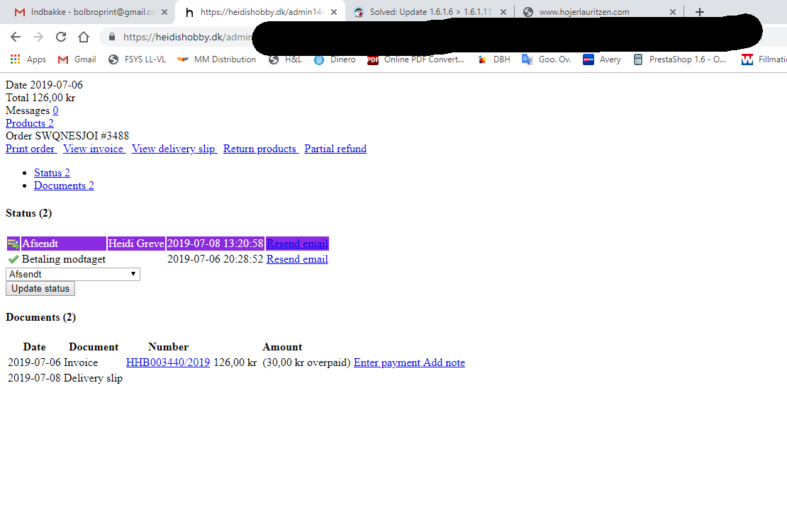

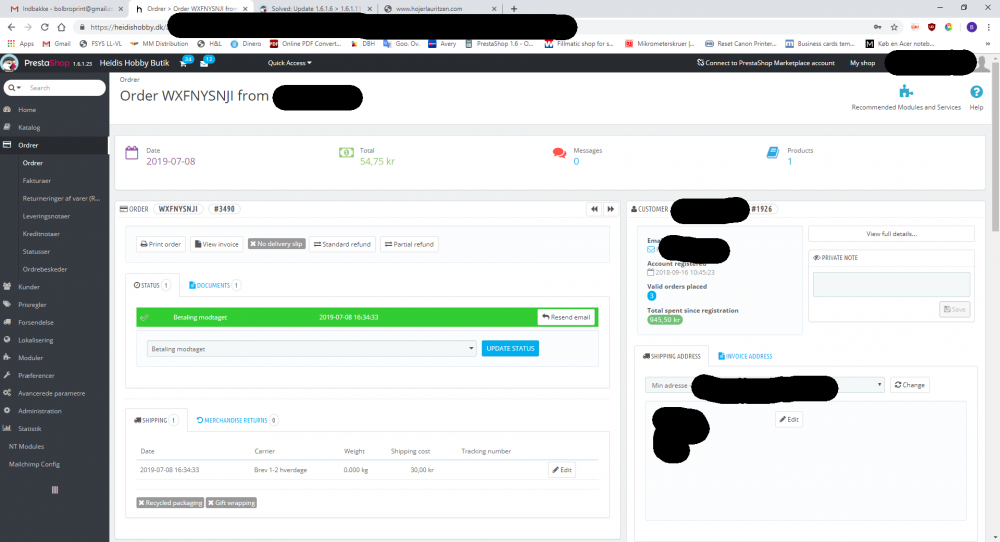

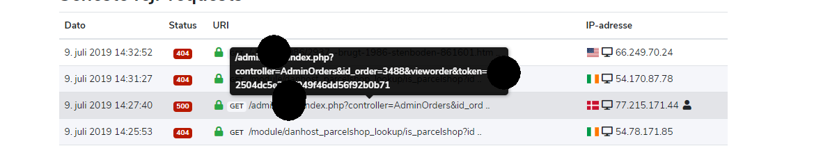

AlleyKat Posted July 9, 2019 Share Posted July 9, 2019 Hm, I have the exact same issue, the exact same place, but not for the same reason I think. Attached example of order with status Payment received. Seems fine. Attached example of order with status Shipped - fails. To the best of my knowledge, no modules has been updated or settings changed. But I did make changes to the site the day it started - I've removed mr/ms social title in 2 OPC template files, and we have worked on translations of the site. Could one of the translations cause this error? Attached entry from the error log (error 500). I have tried the 2 mentioned adv. params settings, no change (and caching is fully disabled atm). I am looking for a guide into how to make a complete translation backup so I can try zeroing the translations to find out if this is the problem. Alternatively, I will try the debug option - maybe I should start with that? Any hints or help appreciated. Link to comment Share on other sites More sharing options...
