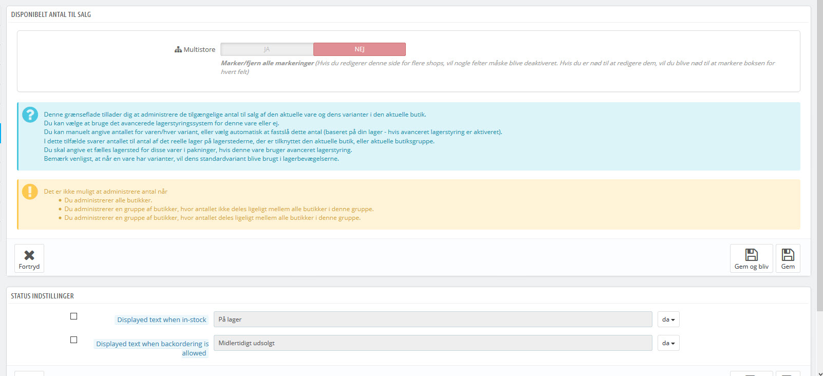

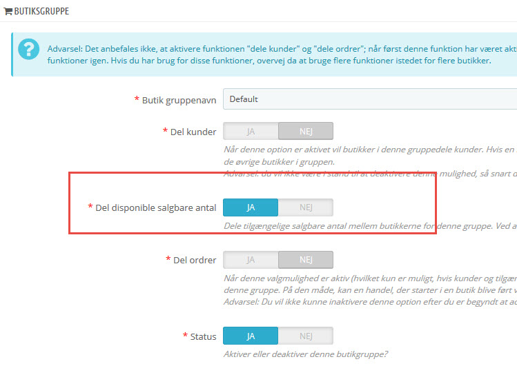

Prestafan1234 Posted March 17, 2017 Share Posted March 17, 2017 I have the same problem in a newly installed shop 1.6.1.11. It is not possible to set the stock amount. I am wondering if it is a bug in the newest version?? I have set up many multistores for clients and usually it work in this way: In Multistore settings, allow the shops to share stock Create product in All shops context Add stock for all shops on this product What I experience now, is that there is simply no where to specify stock on the product - no mater which shop context you view the product in. There is just a warning that it is not possible to specify stock when working in multistore. Also if I switch to Multistore at the top of the screen and hit Save, it just switches back to No I have attached some screen dumps for illustration. The shop is in Danish, but hopefully it still makes sense. Can someone confirm that this is a bug - or have I totally overlooked something? EDIT: I will hurry up at correct the above - You must be in shop context Default group to edit stock (not All shops). Now it workes like in previous versions for me. To the original poster, make sure you have the settings mentioned above:-) Link to comment Share on other sites More sharing options...
