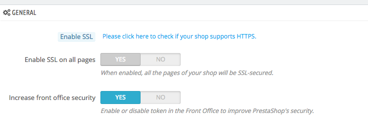

cbai Posted February 24, 2017 Share Posted February 24, 2017 I need help solve the SSL issue right away. We have installed Prestashop 1.7 and SSL for our website on AWS but it's not working. Here is the issue:1. It says Enable SSL in the backend (see screenshot attached here)2. The toggle option Yes, No was available earlier on so I selected either Yes or No. After trying to select several times, the toggle option has become something like the screenshot. Enable SSL is now showing the blue link on the right: "Please click here to check if your shop supports HTTPS." 3. Clicking the link takes me the url like this "https://https//www.abc.com/" and the error message in the browser is displayed like this: ------------------------------------This site can’t be reachedhttps’s server DNS address could not be found.Try running Network Diagnostics.DNS_PROBE_FINISHED_NXDOMAIN--------------------------------------------------------------Any clue? Your insight is highly appreciated! Link to comment Share on other sites More sharing options...
bellini13 Posted February 25, 2017 Share Posted February 25, 2017 check that you have properly configured the domain and ssl domain in the Traffic and SEO page in the back office. It should be only the domain name www.abc.com not including http or https Link to comment Share on other sites More sharing options...

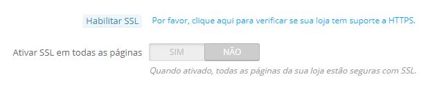

William Monteiro Posted October 31, 2017 Share Posted October 31, 2017 Estou com o mesmo problema... parece sem solução... o meu servidor de hospedagem Kinghost diz que eu tenho que fazer uma apontamento de DNS do prestashop e particularmente eu não tenho ideia de como fazer para reparar isto. Alguém pode me ajudar? Link to comment Share on other sites More sharing options...
