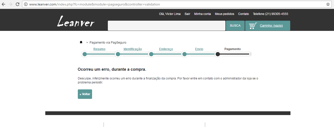

hostnetconta Posted February 22, 2017 Share Posted February 22, 2017 Boa tarde, Estou tendo problema com o Pagseguro na minha loja online, quando o cliente vai finalizar uma compra aparece a seguinte mensagem, alguém pode me ajudar ? Link to comment Share on other sites More sharing options...
Daniel - PrestaBR Posted February 22, 2017 Share Posted February 22, 2017 Pela mensagem, não dá pra saber qual o problema. Vc precisa ativar o modo debug e/ou ver os LOGs do servidor, para tentar descobrir qual o erro. Link to comment Share on other sites More sharing options...
hostnetconta Posted February 22, 2017 Author Share Posted February 22, 2017 Amigo, veja.. {2017/02/22 15:55:48} [info] PagSeguroPaymentService.Register(PagSeguroPaymentRequest: array ( 'Reference' => 'kaX2x2', 'SenderEmail' => '[email protected]', )) - begin {2017/02/22 15:55:48} [info] PagSeguroPaymentService.Register(PagSeguroPaymentRequest: array ( 'Reference' => 'kaX2x2', 'SenderEmail' => '[email protected]', )) - end {1}01A369603C3C9DA994372FBE7A6FBC2E {2017/02/22 16:05:21} [info] PagSeguroPaymentService.Register(PagSeguroPaymentRequest: array ( 'Reference' => 'kaX2x3', 'SenderEmail' => '[email protected]', )) - begin {2017/02/22 16:05:22} [Error] PagSeguroPaymentService.Register(PagSeguroPaymentRequest: array ( 'Reference' => 'kaX2x3', 'SenderEmail' => '[email protected]', )) - error [HTTP 400] - BAD_REQUEST 0 [11035] - Item weight invalid Value: 0.3 Link to comment Share on other sites More sharing options...
