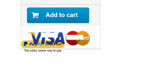

gsc1ugs Posted February 13, 2017 Share Posted February 13, 2017 Hi on checkout img over an image, please see pic attached, why is that? Link to comment Share on other sites More sharing options...

gsc1ugs Posted February 23, 2017 Author Share Posted February 23, 2017 see the attached, has anyone any idea on this please? Link to comment Share on other sites More sharing options...
Dave L Posted February 23, 2017 Share Posted February 23, 2017 Well I'm not a coder but I may be able to point you in the right direction. Didn't get much time to look as your site went off line. The margin-top is a -30px causing the paypal button to sit too high. See the difference with a 30px margin-top I believe this would be in one of your themes .css files but I'm not sure which one. global.css (?) so you will need to find it and get rid of that minus. I did see another issue with your paypal on your final step of checkout. For me I would un-install your paypal module, check that nothing appears here at all and then re-install it. Sort that out first and see if your initial problem still exists. Link to comment Share on other sites More sharing options...

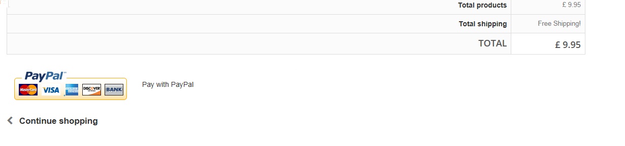

gsc1ugs Posted February 24, 2017 Author Share Posted February 24, 2017 I had 2 paypal modules, turned express off now fine but, the VISA img has vanished? only prob now is last page has the paypal on the wrong side and the big gree proceed to checkout vanishes on page 5 see img? Link to comment Share on other sites More sharing options...
Dave L Posted February 24, 2017 Share Posted February 24, 2017 Hi I just took another look. For me it all looks as it should other than the box around it. This is how mine looks: But it does work, it took me directly to the Paypal page. What version of Prestashop and what version is your Paypal module? Link to comment Share on other sites More sharing options...

gsc1ugs Posted February 24, 2017 Author Share Posted February 24, 2017 Ok cool thanks ive updated, thing is, the paypal stuff links to pay is still too the left Link to comment Share on other sites More sharing options...
