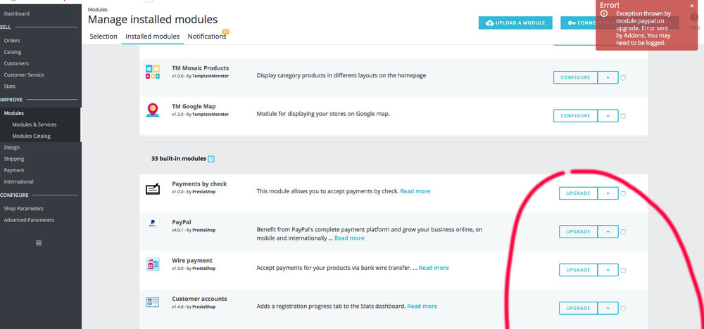

a5dev Posted February 13, 2017 Author Share Posted February 13, 2017 (edited) But ... the original problem still remains, which is: If I log into the back end of my fresh install of PS 1.7.0.4, go to Module > Modules & Services, click on the Installed Modules tab and then click the 'Upgrade' button (next to ANY module that says an update is available) ... I get this error message all the time: "Exception thrown by module xxx on upgrade. Error sent by Addons. You may need to be logged." What does "You may need to be logged" mean ??? Does this mean I need to log *in*? Where? Into the Addons marketplace? I clicked the 'Connect to Addons Marketplace' button at the top of this page, but when I try to log in using my Addons credentials (which I KNOW are correct), I get an error that the login is incorrect. (If I open a new tab and go to https://addons.prestashop.com I am able to log in just fine, using the same login and password) Edited February 14, 2017 by a5dev (see edit history) Link to comment Share on other sites More sharing options...

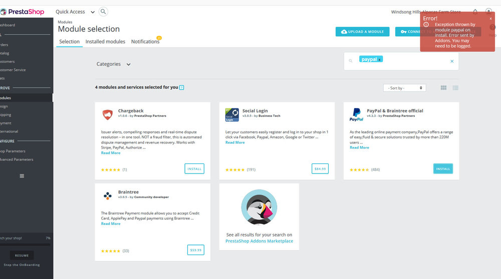

madox-nola Posted May 25, 2018 Share Posted May 25, 2018 (edited) Guys, I have a new install and I can't add any modules to my new install. I am getting the error. Exception thrown by module paypal on install, Error sent by Addon's. You may need to be logged. It happens on all modules, not just paypal. Does anyone have an ideas to fix this error, please. Edited May 25, 2018 by madox-nola (see edit history) Link to comment Share on other sites More sharing options...
