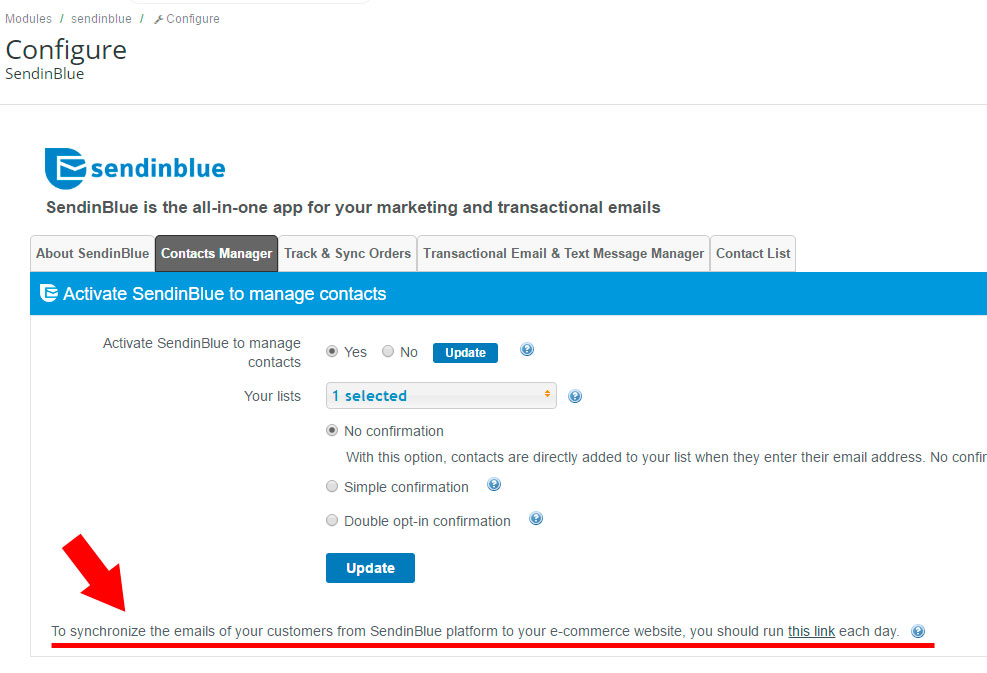

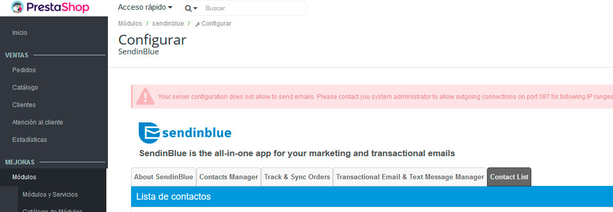

Malemi Posted February 8, 2017 Share Posted February 8, 2017 (edited) Hello, I am trying SendinBlue addon for PrestaShop, I would like to share my early feed back: First problem: I cannot sync back contacts from SendinBlue to PrestaSHop, for instance: a removed subscriber located in SendinBlue list will not be removed in our PrestaShop list (even running a sync cron job suposed to do it). Once installed I attemp to configure, 40 seconds waiting to get to "Configure" panel ! Once inside settings panel, I am required - please check attached pic : "Your server configuration does not allow to send emails. Please contact you system administrator to allow outgoing connections on port 587 for following IP ranges ... " I have been asking to support, they say it is for SMTP mails. Me using PHP mails setting, even so they say we cannot remove that message! That seems to me a bit weird, could someone give a feed back-up on SendinBlue, how does it really work? Me doing something wrong ?? Me, using PS 1.7.0.4. Thank you Malemi Edited February 9, 2017 by Malemi (see edit history) Link to comment Share on other sites More sharing options...
Malemi Posted February 24, 2017 Author Share Posted February 24, 2017 Hello, As a follow up of this thread, I have been asked by SendinBlue support to enable SMTP mails in order to fix 40 seconds waiting to get to "Configure" panel. I am going to have a try and give here a feed-back. Still cannot sync back contacts from SendinBlue to PrestaSHop, Best Regards Link to comment Share on other sites More sharing options...
Malemi Posted February 26, 2017 Author Share Posted February 26, 2017 Hello, Fist issue has been fixed by enabling SMTP mails :-) Still cannot sync back contacts from SendinBlue to PrestaSho, we are trying to get it fixed. Me using PS 1.7.0.5 I will let you know. Best Regards Link to comment Share on other sites More sharing options...

Malemi Posted February 28, 2017 Author Share Posted February 28, 2017 Hello, I forgot to upload the following screen-shot in order to point out and display my issue. The following is supposed (as far as I understand) to be the manual cronjob to sync back from SendinBlue to PrestaShop. As far as I can try this out, it seems not working with PS 1.7 Any help will be appreciated! Link to comment Share on other sites More sharing options...
