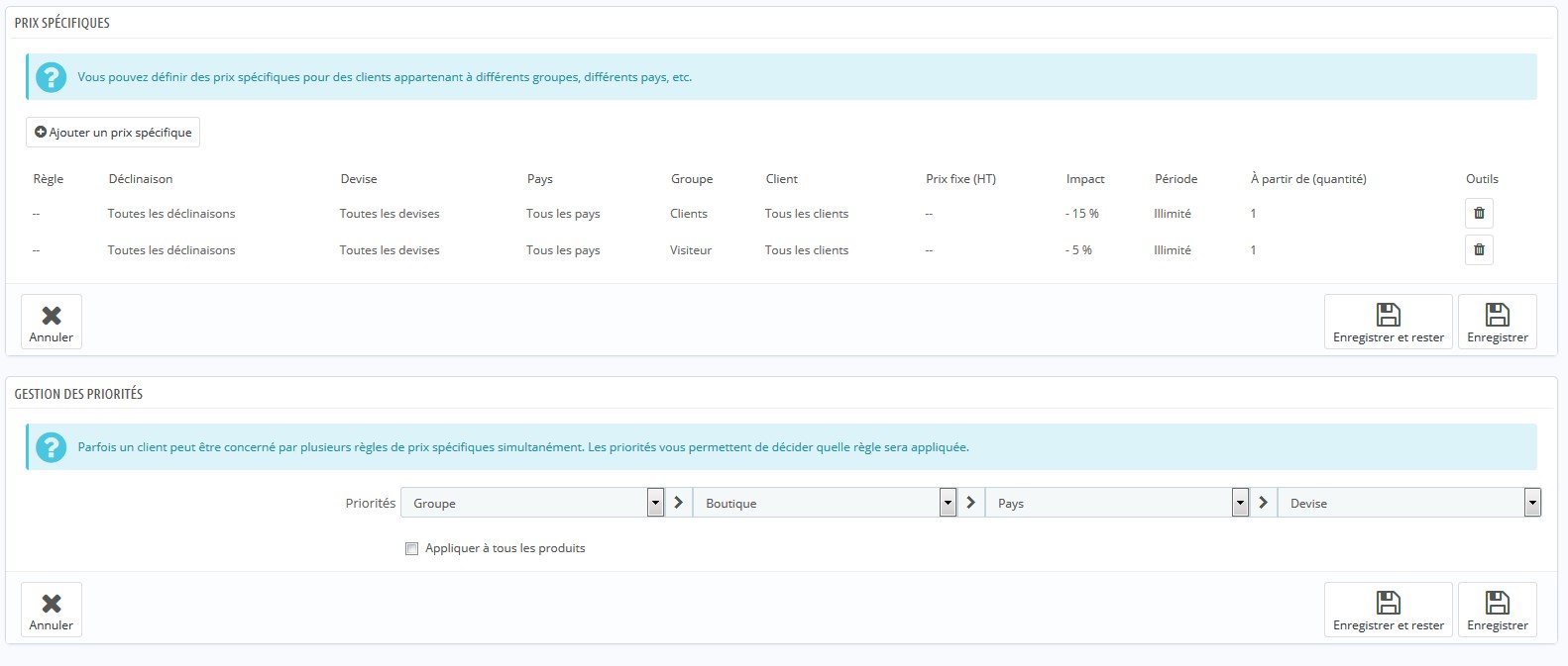

Tchupa Posted February 9, 2017 Author Share Posted February 9, 2017 (edited) Bonjour, j'applique une remise spécifique a un groupe sur la fiche article dans l'onglet prix. Edited February 9, 2017 by Tchupa (see edit history) Link to comment Share on other sites More sharing options...
Tchupa Posted February 9, 2017 Author Share Posted February 9, 2017 Voilà ce que j'ai avec les priorités Link to comment Share on other sites More sharing options...
Tchupa Posted February 9, 2017 Author Share Posted February 9, 2017 j'ai fait le test sur une version propre et sa fonctionne, c'est bien ce qui m'inquiète. Penses tu que sa pourrait provenir d'un problème niveau BDD? Link to comment Share on other sites More sharing options...
Tchupa Posted February 9, 2017 Author Share Posted February 9, 2017 (edited) Oui bien sûr: Edited April 20, 2021 by Tchupa (see edit history) Link to comment Share on other sites More sharing options...
