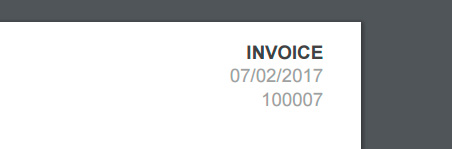

Malemi Posted February 8, 2017 Share Posted February 8, 2017 Hello, I am using PS 1.7.0.4, default language is Spanish. Cannot translate "INVOICE" word located at the top right of invoice PDF (please look at pic attached). Opening pdf/header.tpl it seems "INVOICE" is not available for translation: {if isset($header)}{$header|escape:'html':'UTF-8'|upper}{/if} Please, any help to translate it? Me could remove and write there directly being this not the best fix (I guess this file is being used by other PDF files). Thank you Malemi Link to comment Share on other sites More sharing options...
Malemi Posted February 8, 2017 Author Share Posted February 8, 2017 That seems to be a bug, For anyone interested, just seen it has already been pointed out here http://forge.prestashop.com/browse/BOOM-1984 It seems to be resolved, waiting for next version to check it out. Thank you Link to comment Share on other sites More sharing options...
