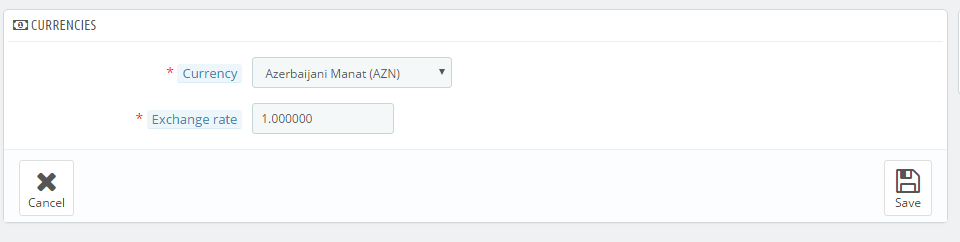

Elchin Posted January 23, 2017 Share Posted January 23, 2017 (edited) Hi everybody, In Prestashop 1.6 there was a currency format edit forum, but in Prestashop 1.7 it dissapeared. My local currency format is not correct and I cannot modify it from admin panel. I am very new to Prestashop. Can anyone help me to find the actual file and edit it from there? I believe, it is in translation files, but I checked almost every file, couldn't find it. Thanks in advance. Edited January 23, 2017 by Elchin (see edit history) Link to comment Share on other sites More sharing options...

Elchin Posted January 26, 2017 Author Share Posted January 26, 2017 I solved the problem. After installing localization pack I found currency file in the "translations\cldr" folder and edited it from there. Link to comment Share on other sites More sharing options...
