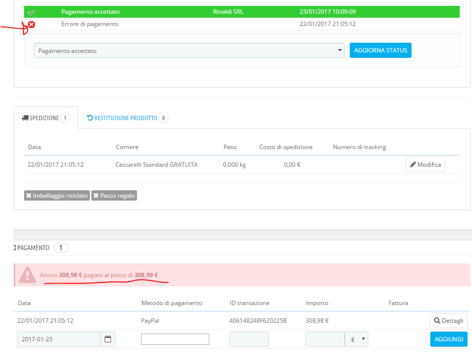

claudiaIta Posted January 23, 2017 Share Posted January 23, 2017 Hi, after upgrading my prestashop to the 1.6.1.10, in the latest orders i get in the BO the "payment error" status when an order is payed with paypal, even if money has actually been received to paypal account. Then in order page in BO there's this error like this : payed 308,98€ instead of 308,99€ Can somone please advise me? At the moment i just hide the status to the customer. Screen shot of the bug is attached Thank you Link to comment Share on other sites More sharing options...
bellini13 Posted January 23, 2017 Share Posted January 23, 2017 so look in your paypal account and confirm the actual amount paypal received. was it 308,98€ instead of 308,99€ ? Link to comment Share on other sites More sharing options...
claudiaIta Posted January 24, 2017 Author Share Posted January 24, 2017 do you mean that i should just confirm the payment from the BO changing the status to "payment received" ? I can't confirm manually every single order that's payed with paypal and gets this error. However it is correct the first amout. I red from a similar old post that it's caused by the rounding of prestashop that is different from paypal. So maybe i should try different configuration in settings > general Link to comment Share on other sites More sharing options...
bellini13 Posted January 24, 2017 Share Posted January 24, 2017 no, i mean you should literally confirm what amount paypal took from the customer. Prestashop is telling you that the amount of the order, and the amount that paypal took are different. .98 is not the same as .99 308,98€ instead of 308,99€ So, start by first confirming what amount Paypal really took, and confirm that the error is real Link to comment Share on other sites More sharing options...
