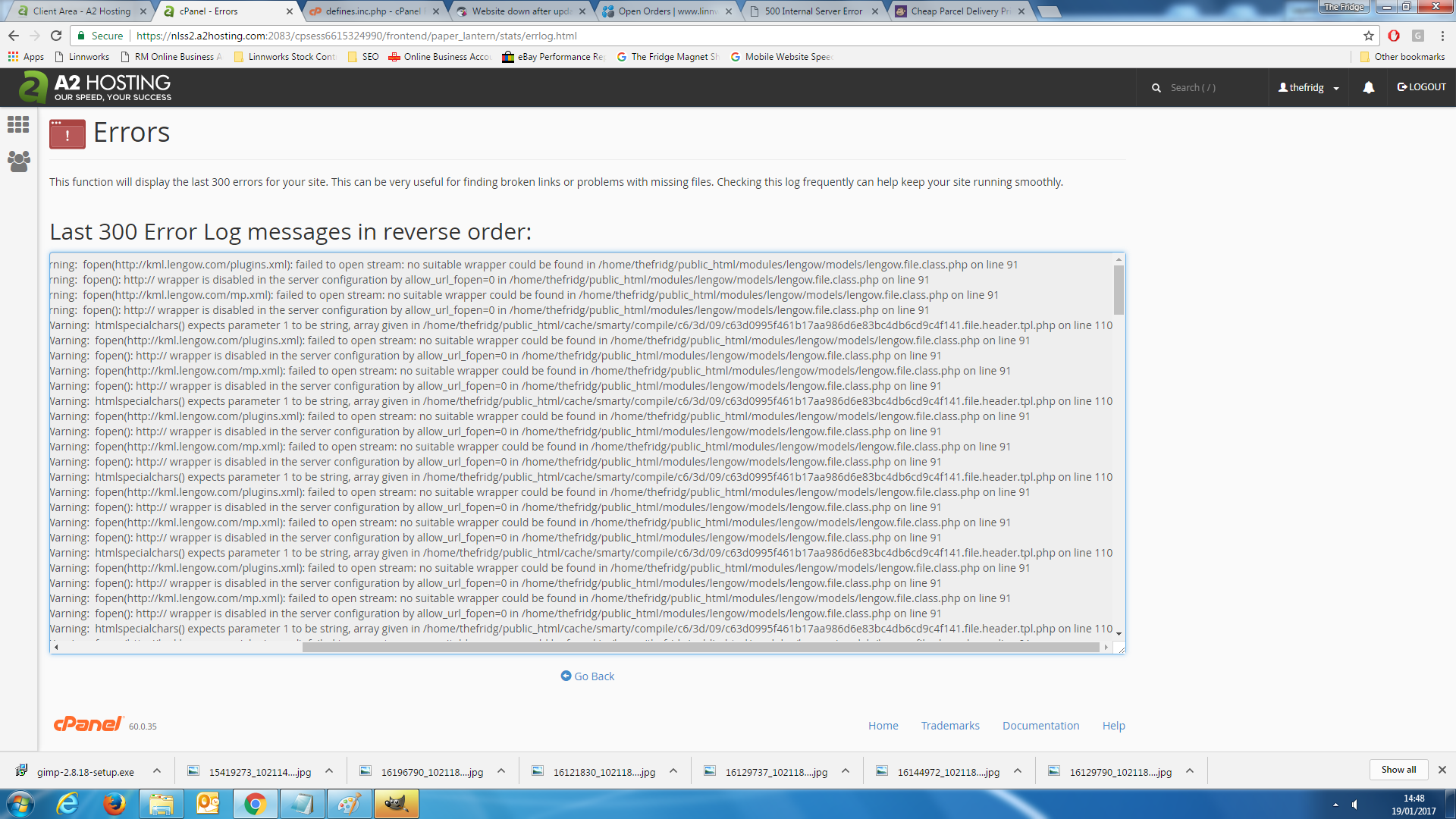

thefridgemagnetshop Posted January 19, 2017 Author Share Posted January 19, 2017 Ok, I found the debug messagesFront Office:Back Office:And this is our error log? I'm not really sure what PHP version we have? Link to comment Share on other sites More sharing options...
razaro Posted January 19, 2017 Share Posted January 19, 2017 OK I see your site is back with just few error messages Warning/home/thefridg/public_html/modules/lengow/models/lengow.file.class.php on line 91Warning: fopen(http://kml.lengow.com/mp.xml): failed to open stream: no suitable wrapper could be found in /home/thefridg/public_html/modules/lengow/models/lengow.file.class.php on line 91Warning/home/thefridg/public_html/modules/lengow/models/lengow.file.class.php on line 91Warning: fopen(http://kml.lengow.com/plugins.xml): failed to open stream: no suitable wrapper could be found in /home/thefridg/public_html/modules/lengow/models/lengow.file.class.php on line 91 Try to disable that module, contact developer. Check this "wrapper is disabled in the server configuration by allow_url_fopen=0 " with your hosting. And do not forget to disable debug mode. Those worrnigs will be hidden. But this could be from something else but better to have fully working module too. Link to comment Share on other sites More sharing options...

thefridgemagnetshop Posted January 24, 2017 Author Share Posted January 24, 2017 The error we are getting is:[Tue Jan 24 10:53:03 2017] [error] [client 81.137.251.134] PHP Warning: fopen(http://kml.lengow.com/plugins.xml): failed to open stream: no suitable wrapper could be found in /home/thefridg/public_html/modules/lengow/models/lengow.file.class.php on line 91, referer: http://thefridgemagnetshop.co.uk/admin869/index.php?controller=AdminLogin&token=144f1055b452f64479e84f96858765bemodules/lengow/models/lengow.file.class.php on line 91, referer: http://thefridgemagnetshop.co.uk/admin869/index.php?controller=AdminLogin&token=144f1055b452f64479e84f96858765beI've looked on line 91 but I can't really see anything obvious to me, but I'm not an expert in CSS or coding so I'm not really sure what I should be looking for anyway. I've attached a screenshot of this area of coding.Any help you can give would be great! thank u so much Link to comment Share on other sites More sharing options...
bellini13 Posted January 24, 2017 Share Posted January 24, 2017 Well at least you know it is a custom module causing the issue. Remove the module from the file system and then try to login again. Then contact the author of the module Link to comment Share on other sites More sharing options...
