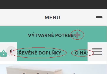

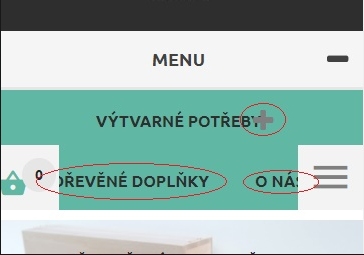

pavel Posted December 29, 2018 Share Posted December 29, 2018 I still have the same problem on mobile device: Next problem is when I open web in ipad. After click on button menu, not happen (the menu does not open ). I tried it on computer, menu not working when page width is 768 - 970. Please help. Link to comment Share on other sites More sharing options...
