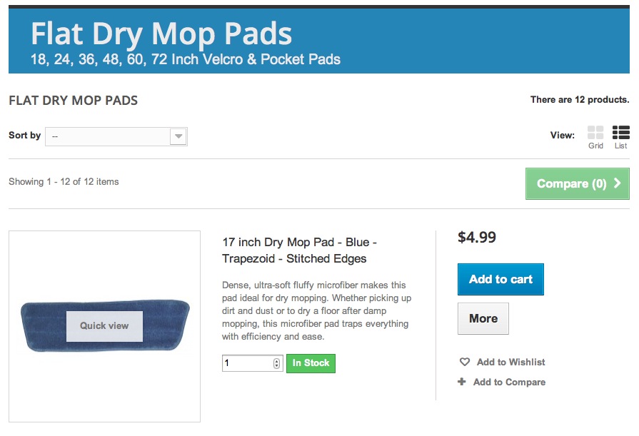

lepusa Posted January 16, 2017 Share Posted January 16, 2017 (edited) Currently by default in the item view, the item reference number is shown just below the product description, such as on this page. We would like product reference numbers to appear in the items list view. Can this be done? See these two screen shots from this page for example: Edited January 18, 2017 by lepusa (see edit history) Link to comment Share on other sites More sharing options...
