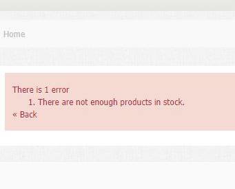

kamppa Posted January 12, 2017 Share Posted January 12, 2017 (edited) I found out a way to create a solution to this. The only problem is that this does not work with ajax so a manual page refresh is needed when customer changes product quantities in cart. Would be great if someone could continue with the development or help point me in the direction of how to add ajax functionality to this! Here's a solution to show availability warning when customer orders more products than there is in stock. This is needed because I want to allow ordering products that are out of stock. Pardon my quick and dirty translations with paint in the screenshot. Stock quantity is not visible for customers although I wrote it in the screenshot for you to see how this works. This allows the competitors to use cart to spy how many products you have in stock if they test adding products to the cart for as long as the availability status will change. This does not concern me as I care more about customer satisfaction so that they know how many of their ordered products will de delivered immediately and how many of them will be backordered. Screenshot: Needed modifications: shopping-cart-product-line.tpl modify the corresponding part: {if $PS_STOCK_MANAGEMENT} <td class="cart_avail"> {if $product.quantity_available < $product.cart_quantity && $product.quantity_available >= 0}<span class="backorderedown">{l s='%d backordered' sprintf=$product.cart_quantity - $product.quantity_available}</span>{else} {if $product.quantity_available <= 0}<span class="notavailableown">{if $product.allow_oosp}{if isset($product.available_later) && $product.available_later}{$product.available_later}</span>{else}<span class="availableown">{l s='In Stock'}</span>{/if}{else}<span class="backorderedown">{l s='Backordered'}</span>{/if}{else}<span class="availableown">{if isset($product.available_now) && $product.available_now}{$product.available_now}</span>{else}<span class="availableown">{l s='In Stock'}</span>{/if}{/if}{hook h="displayProductDeliveryTime" product=$product} </td> {/if} global.css add these: .availableown { background-color: #5cb85c; display: inline; padding: .1em .4em .2em; font-size: 88%; font-weight: bold; line-height: 1; color: white; text-align: center; white-space: nowrap; vertical-align: baseline; border-radius: .25em; } .backorderedown { background-color: #f0ad4e; display: inline; padding: .2em .6em .3em; font-size: 75%; font-weight: bold; line-height: 1; color: white; text-align: center; white-space: nowrap; vertical-align: baseline; border-radius: .25em; } .notavailableown { background-color: #d9534f; display: inline; padding: .2em .6em .3em; font-size: 75%; font-weight: bold; line-height: 1; color: white; text-align: center; white-space: nowrap; vertical-align: baseline; border-radius: .25em; } Please tell me how can I modify the code to make availability status change immediately using ajax when customer changes product quantities in cart? Edited January 12, 2017 by kamppa (see edit history) Link to comment Share on other sites More sharing options...

MajkisMikiman Posted July 6, 2017 Share Posted July 6, 2017 Hello. He came to the state-of-the-art upgrade solution.In the themes / your_theme / js / cart-summary.js file, find function upQuantity (id, qty) at line 578For this function, complete the following function after the closed race: function updateCartAvailability(json) { var i; var product_list = new Array(); if (typeof json == 'undefined') return; $('div.error').fadeOut(); for (i=0;i<json.products.length;i++) product_list[json.products[i].id_product + '_' + json.products[i].id_product_attribute + '_' + json.products[i].id_address_delivery] = json.products[i]; for (i in product_list) { var key_for_blockcart_nocustom = product_list[i].id_product + '_' + product_list[i].id_product_attribute + '_' + ((product_list[i].quantity_without_customization != product_list[i].quantity)? 'nocustom' : '0') + '_' + product_list[i].id_address_delivery; if (product_list[i].quantity_available - product_list[i].cart_quantity >= 0) { $('#product_' + key_for_blockcart_nocustom + ' .cart_ref').html('<span class="availableown">{l s='In Stock'}</span>'); } else if (product_list[i].quantity_available - product_list[i].cart_quantity < 0 && product_list[i].allow_oosp) { $('#product_' + key_for_blockcart_nocustom + ' .cart_ref').html('<span class="backorderedown">{l s='%d backordered' sprintf=$product.cart_quantity - $product.quantity_available}</span>'); } else if (product_list[i].quantity_available - product_list[i].cart_quantity < 0 && !product_list[i].allow_oosp) { $('#product_' + key_for_blockcart_nocustom + ' .cart_ref').html('<span class="availableown">{l s='Out of stock'}</span>'); } } } I´m sorry for ma english. Link to comment Share on other sites More sharing options...
