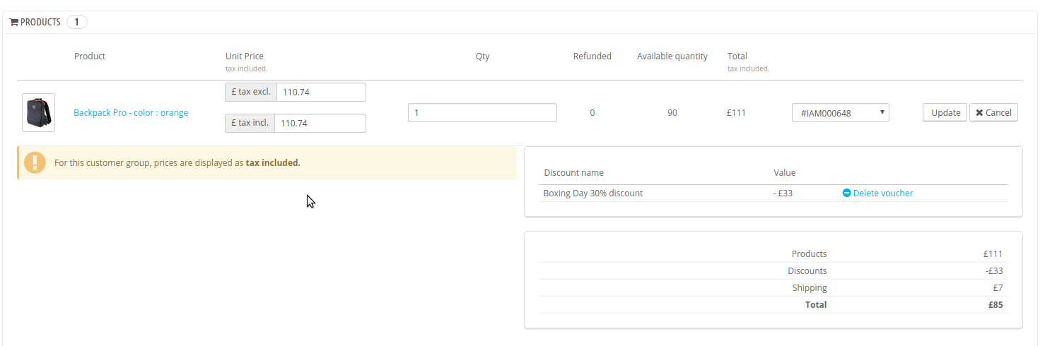

rewuxiin Posted January 6, 2017 Share Posted January 6, 2017 (edited) payment error - warning £85 paid instead of £85 A stripe of pay if the module - all ok if pay Paypal module - error However, the operation is carried out in Paypal, after payment - get the Confirmed, the database status paypal confirmed as the same data module Where validation occurs after the payment? What could affect the occurrence of this error? Edited January 6, 2017 by rewuxiin (see edit history) Link to comment Share on other sites More sharing options...

rewuxiin Posted January 8, 2017 Author Share Posted January 8, 2017 On 1/8/2017 at 1:33 AM, shokinro said: For example in database it was €85.01 and €85.02, but you displayed as €85 because for your displaying format configuration? Yes I have off Decimals. Example this product price = 110.74 and cart rule = -30% Link to comment Share on other sites More sharing options...
bellini13 Posted January 8, 2017 Share Posted January 8, 2017 it is a defect in prestashop. if you turn off decimals, prestashop still stores the values in decimal in the database, but you are sending the non-decimal (rounded) value to paypal. so after payment is made, prestashop checks the payment amount against the database's decimal (non-rounded) value and they do not match, and you get an error since EUR has decimals, your best bet is to turn them back on 1 Link to comment Share on other sites More sharing options...
