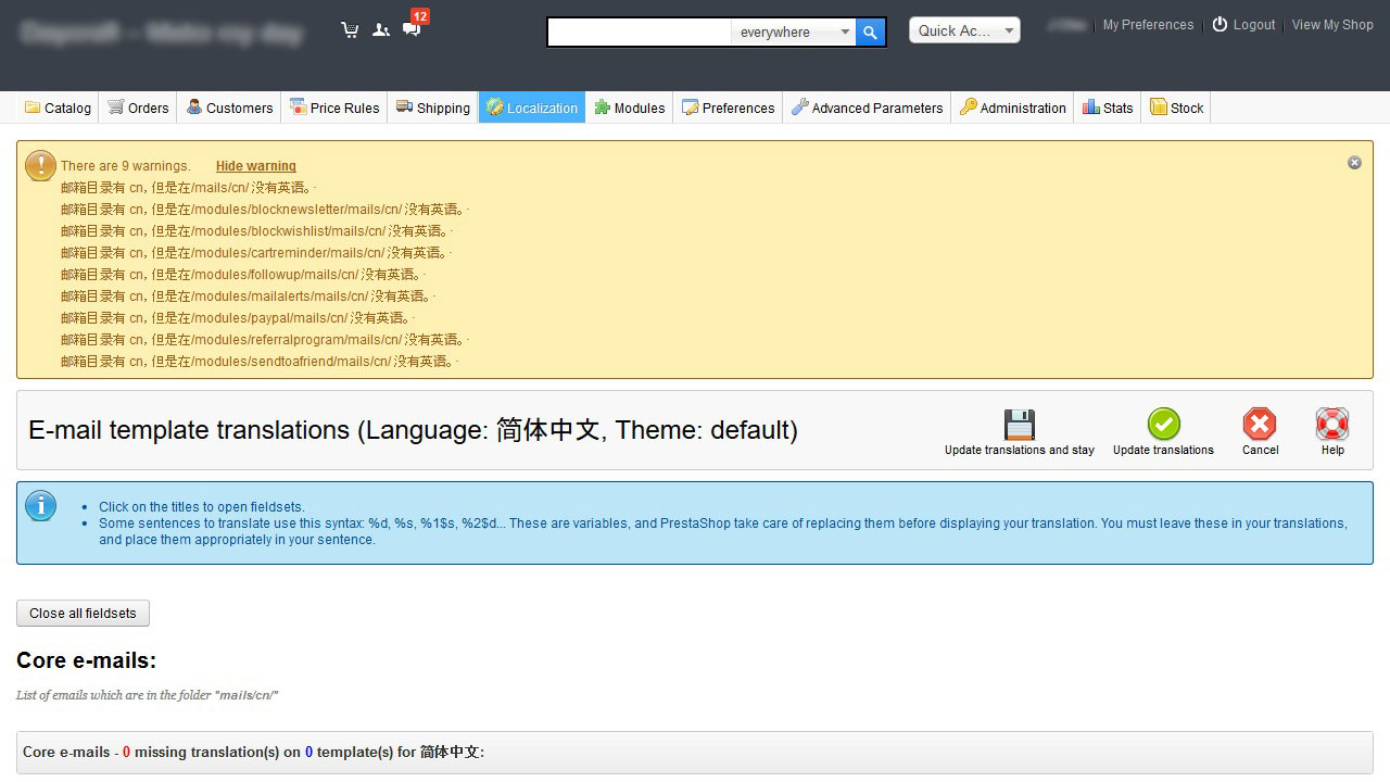

Recently I've had to do some module work (abandoncart) on all sites. Done everything and all is well until I had to deploy to /cn/
Module installs and everything looks fine until I try to edit email template translations in the BO, where I get the following errors (attached), for CN language only. other languages work fine, and other sections of translation work fine (front/back office, etc. only email templates fail)
I have tried to do what it suggested, putting en inside cn again but to no avail. I have tried other solutions posted by others with a similar issue e.g. copying /root/mails/cn/ folder into /root/themes/mytheme/mails/cn/, deleting the /mails/cn/ folder and let BO create it.
I suspect the language code "cn" is clashing with the subfolder name of which it's installed in.

Solved the problem.
I was correct in suspecting it was a clash between the folder name and ISO code of the language "cn"
in /controllers/admin/AdminTranslationsController.php - 1851
$dir_en = str_replace('/' . $this->lang_selected->iso_code . '/', '/en/', $dir);
Edited the code so it only replace the last instance of the iso_code instead of all of them.
