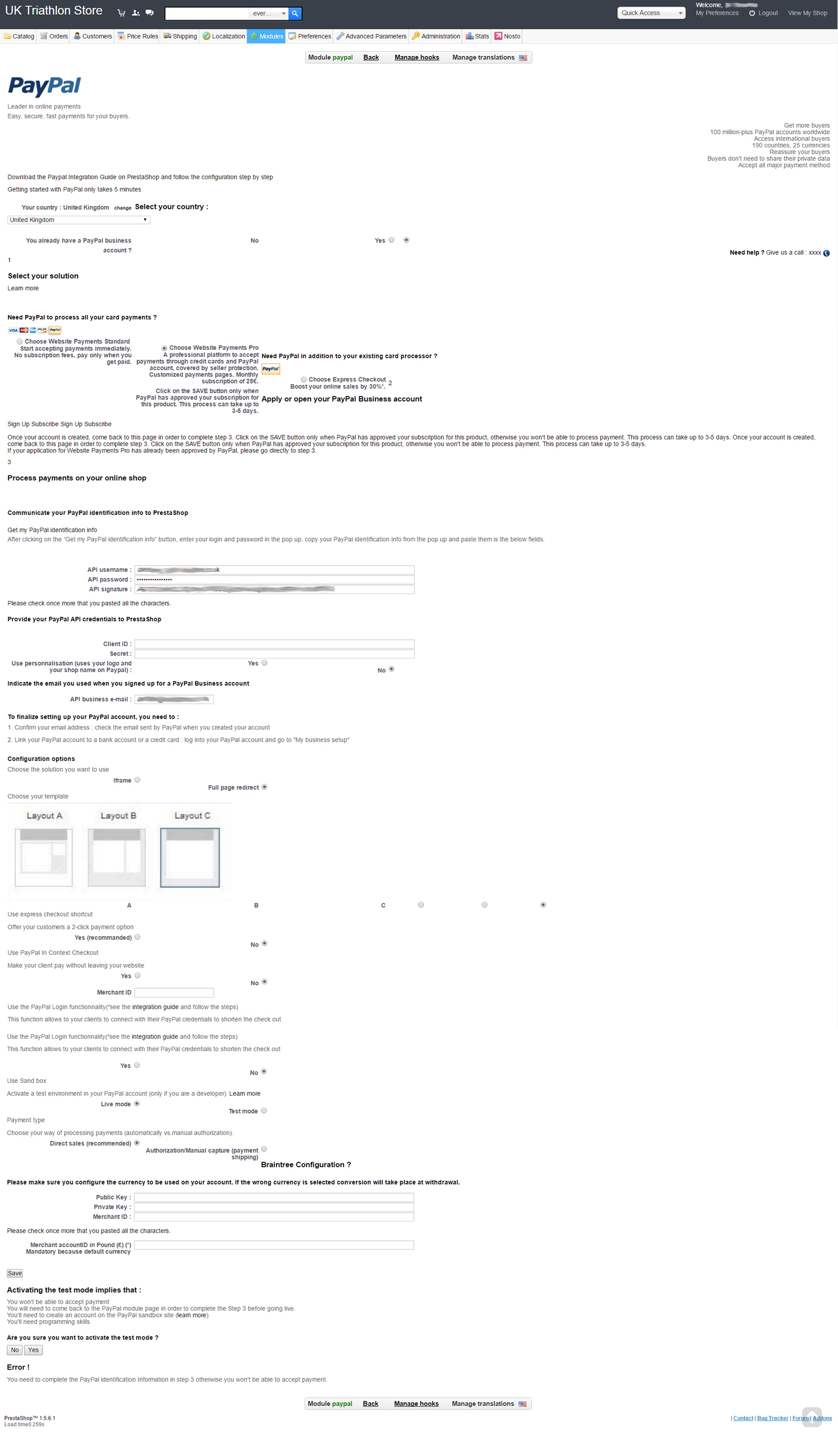

ferg Posted January 5, 2017 Share Posted January 5, 2017 Hi all Sorry if this is a really daft question but... The site has been using PayPal for 6 years without issue, then on Monday PayPal broke something which resulted in an error page coming up instead of redirecting to PayPal. They have now fixed it, but there are no completed orders in the BO despite payments being received in PayPal. So, having PayPal support tell me that I need to add IPN to PayPal account I reviewed the PS/PayPal set up guide and checked the PS forum to see what you guys have said. It would appear that I need to add an IPN notification to the PayPal module - but I have no idea where or what to put! I have attached a screenshot of the PayPal module but I can't see where to add this info. Please help! Thanks Fergus PS v1.5.6.1 PayPal European v 3.11.1 Link to comment Share on other sites More sharing options...

ferg Posted January 5, 2017 Author Share Posted January 5, 2017 Thanks Bellini In my final line I said. "It would appear that I need to add an IPN notification to the PayPal module - but I have no idea where or what to put! I have attached a screenshot of the PayPal module but I can't see where to add this info." Maybe I was not clear enough - how or where does the PS PayPal module take care of this as it's not working? I also got the following back from PayPal Support "I run a test and I see you are using an old integration since it's posting to an old endpoint: Request URL: https://securepayments.paypal.com/acquiringweb instead of https://securepayments.sandbox.paypal.com/webapps/HostedSoleSolu tionApp/webflow/sparta/hostedSoleSolutionProcess This can be easily resolved by updating your cart module. Regarding the values sent by your cart, this is the only one I see that needs to be changed: lc = EN The correct value should be lc = GB See https://www.paypalobjects.com/webstatic/en_GB/developer/docs/pdf/hostedsolution_uk.pdf - page 20 We have modify our code recently in order to prevent merchants passing incorrect values to get errors instead of the payment page, for this reason this change is now recommended but currently not mandatory. Regarding the notification, please check the full explanation about the IPN issue reported in the previous ticket." Do you have any idea how to update the "lc = EN. The correct value should be lc = GB" Thanks Fergus Link to comment Share on other sites More sharing options...
