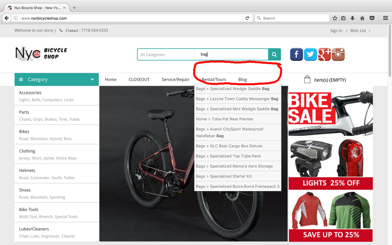

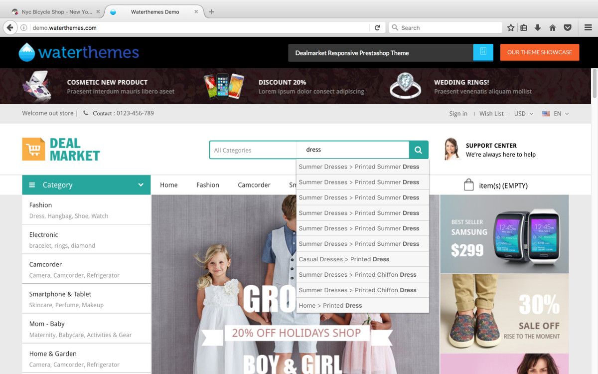

nycbicycleshop Posted December 28, 2016 Share Posted December 28, 2016 (edited) Hi Everybody I am using PrestaShop 1.6.1.4 with Water themes custom template, I have a problem with the WT Quick search module, when I type something on a box the result list shows little far from the search box it doesn't starts under the search box, before it's working perfect, I try to disable the module and enable again also I uninstall and install again clear cache but didn't work.I attach the pictures one is my website and the other water themes demo site screenshot. My Website www.nycbicycleshop.com Thanks for Help Edited December 28, 2016 by nycbicycleshop (see edit history) Link to comment Share on other sites More sharing options...

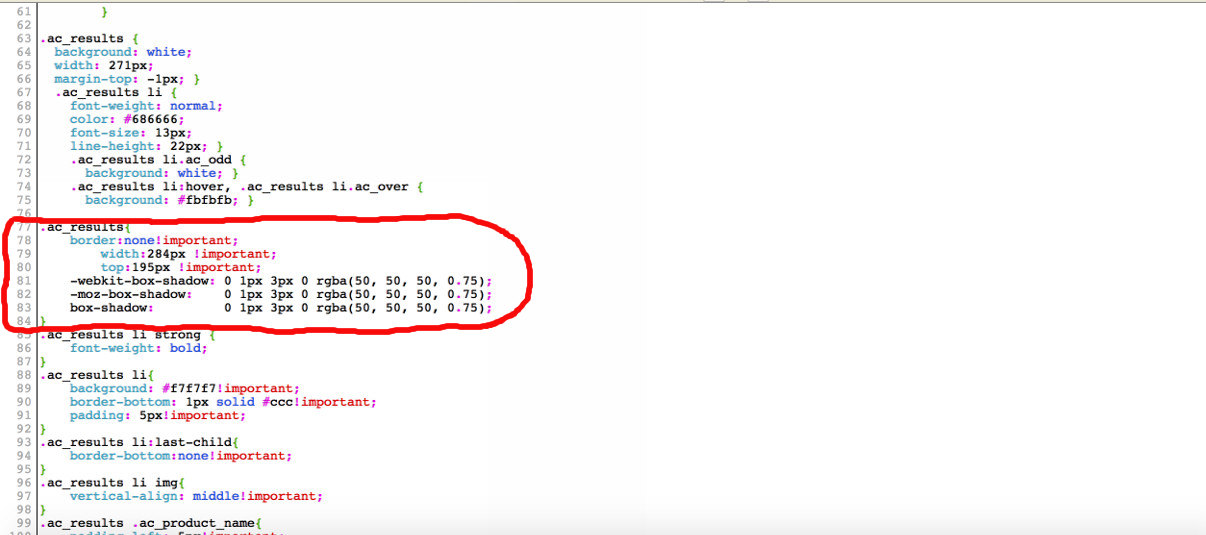

vekia Posted December 28, 2016 Share Posted December 28, 2016 remove top param from: .ac_results { border: none !important; width: 284px !important; top: 195px !important; -webkit-box-shadow: 0 1px 3px 0 rgba(50, 50, 50, 0.75); -moz-box-shadow: 0 1px 3px 0 rgba(50, 50, 50, 0.75); box-shadow: 0 1px 3px 0 rgba(50, 50, 50, 0.75); } you can find it in file:http://www.nycbicycleshop.com/themes/wt_dealmarket/sass/modules/wtblocksearch/views/css/wtsearch.scss line 77 Link to comment Share on other sites More sharing options...
nycbicycleshop Posted December 28, 2016 Author Share Posted December 28, 2016 (edited) Hi Vekia Thanks for the quick reply, I just want to make sure I have to remove line 77 till 84 ? Edited December 28, 2016 by nycbicycleshop (see edit history) Link to comment Share on other sites More sharing options...
nycbicycleshop Posted December 28, 2016 Author Share Posted December 28, 2016 (edited) I just removed the line 77 till 84 I cleared cache but still problem the same. Am I doing wrong something? Edited December 29, 2016 by nycbicycleshop (see edit history) Link to comment Share on other sites More sharing options...

vekia Posted January 2, 2017 Share Posted January 2, 2017 after changes to .css file you have to clear browser cache because it remembers old css file contents Link to comment Share on other sites More sharing options...
Jignesh.aakoliya Posted January 2, 2017 Share Posted January 2, 2017 (edited) I have checked your website and search result. From my firebug, I can see that if you remove top: 195px !important; from .ac_results then it will work perfectly. So remove top and clear cache so it will work as you want.Thanks Edited January 2, 2017 by Jignesh.aakoliya (see edit history) Link to comment Share on other sites More sharing options...
nycbicycleshop Posted January 9, 2017 Author Share Posted January 9, 2017 I try Vekia solution removing line 77 till 84 clear cache from backoffice, clear browser cache and try with another browser didn't work. I try rjigneshkumar solution too removing only line 80 clear cache from backoffice, clear browser cache didn't work too I stuck with this problem. Any Help? Link to comment Share on other sites More sharing options...
