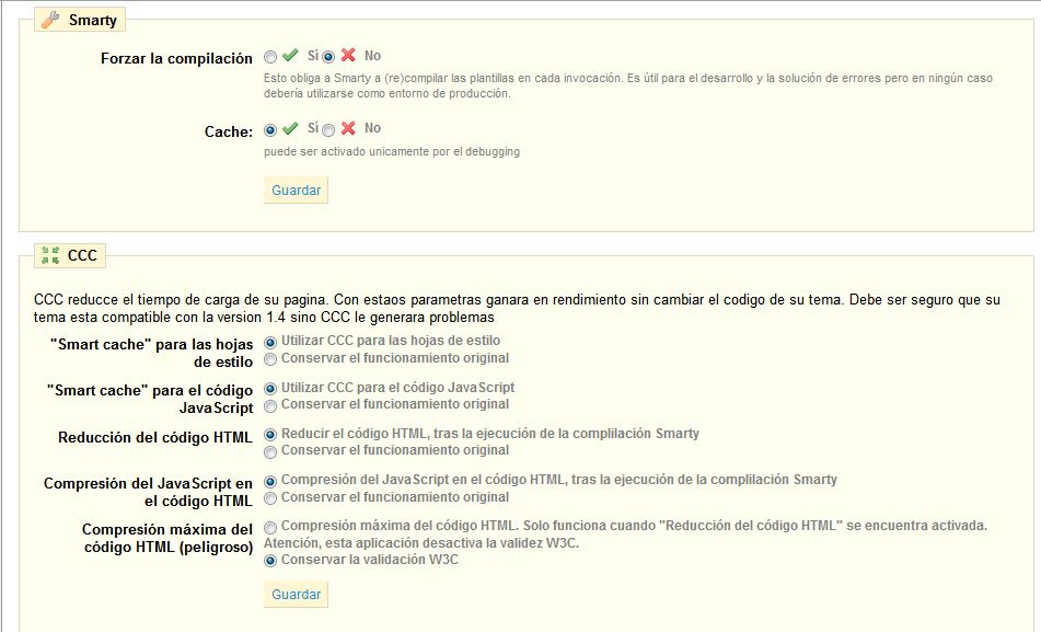

rocky Posted March 19, 2011 Author Share Posted March 19, 2011 I have now updated my Performance Tips for PrestaShop v1.4. Using these tips, I've managed to get a Google PageSpeed score of 92/100 on my website. I'm still trying to get the promised 98 by PrestaShop. I can't seem to get rid of the cookies being passed along with static content, even after setting up a separate static subdomain for the content. Also, my server doesn't support GZIP compression, so that's reducing my score a little. Link to comment Share on other sites More sharing options...

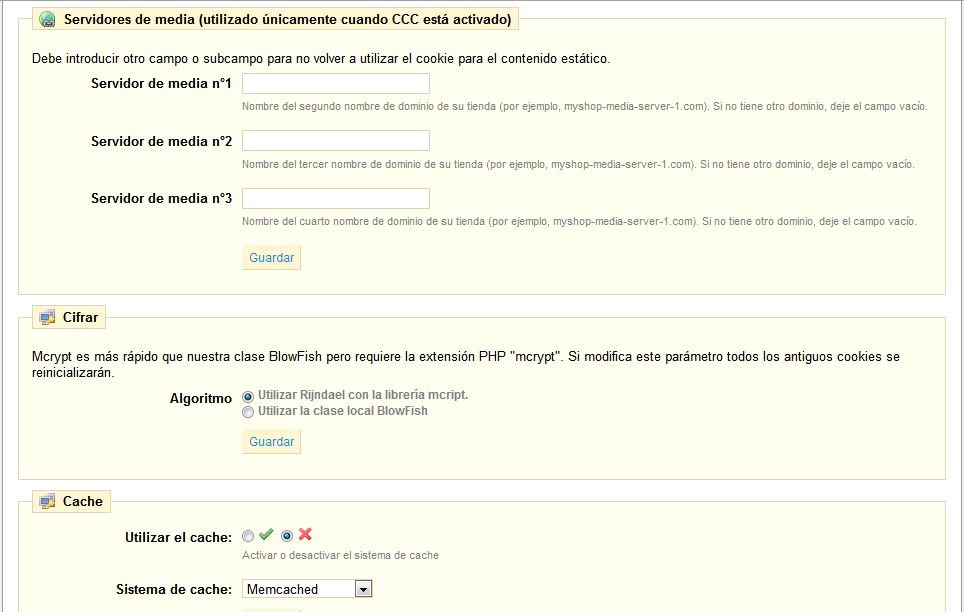

Paul C Posted March 19, 2011 Share Posted March 19, 2011 If you're using subdomains of the domain your shop is on to serve the static content, then you can't get rid of cookies as the shop cookie is set to .example.com - so applies to all subdomains, not just www.Paul Link to comment Share on other sites More sharing options...
rocky Posted March 20, 2011 Author Share Posted March 20, 2011 @angoraThat code is already there in the Enable GZIP Compression and Browser Caching section.@PaulThanks Paul. I thought the cookie was set only to the subdomains entered on the Tools > Subdomains tab. There's a foreach loop in the getDomain() function of classes/Cookie.php that I thought did this. I just tested the output and it returned nethercottconstructions.com, so it seems to have ignored the www subdomain on the Tools > Subdomains tab. Is this a bug I should report? I've only got one domain, so if I can't use a subdomain, then I can't serve static content without cookies. Link to comment Share on other sites More sharing options...
Paul C Posted March 20, 2011 Share Posted March 20, 2011 Rocky,I've submitted selecting the cookie domain as a feature request for this reason. I had a quick look at the code you're talking about too because I though the same as you, but I can't work out what it's meant to achieve.... Apparently the current behavior isn't a bug (I tried and it got cancelled), but looking at that code I'm not so sure!The other issue I had was that my static subdomains aren't covered by the ssl certificate, so when on an ssl page I got security warnings. I fixed that by ignoring the static domains when serving content on an https page.Paul Link to comment Share on other sites More sharing options...
skyhorse Posted May 3, 2011 Share Posted May 3, 2011 using 1.3.1.1, I simply added a new dummy subdomain in the tools -> subdomains area and deleted the www subdomain. This makes prestashop cookie code believe www.domain.com is the domain and not domain.com , hence it puts the cookie on www.domain.comremember to enforce requests coming in using the non-www version to redirect to the www version (in .htaccess for example)I also had to change the google analytics code to force the domain in the request, because it was also setting it to domain.com, you can do this by adding for example _gaq.push(['_setDomainName', 'www.domain.com']); (for async version) before the trackPageView line. Link to comment Share on other sites More sharing options...

rocky Posted May 6, 2011 Author Share Posted May 6, 2011 Have you tried the advice on my website to set "Force compile" to "No" and "Cache" to "Yes" and enable the first four CCC options on the Preferences > Performance tab? You can also use Google PageSpeed in Firefox to download optimised images and use SpriteMe to automatically generate sprites. Another thing you can do is set up a subdomain called "static" using your cPanel, then enter static.yourwebsite.com as a media server. Also, if you are using modules from an earlier version of PrestaShop, you should modify the hookHeader function so that all the JS and CSS are included in the CCC instead of separately. Link to comment Share on other sites More sharing options...
