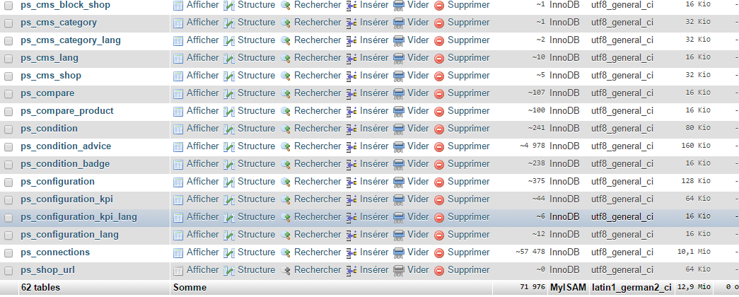

Oussama abaied Posted December 12, 2016 Author Share Posted December 12, 2016 Hello thank you ! i have these tables in these screenshots below : Link to comment Share on other sites More sharing options...
ericzon Posted December 12, 2016 Share Posted December 12, 2016 I'm almost sure your db import process has failed, for that reason you only have until ps_connections on the db. Check that process! 1 Link to comment Share on other sites More sharing options...
Oussama abaied Posted December 12, 2016 Author Share Posted December 12, 2016 i tried to import my db for second time and it was the same result ! so im almost sure now that my db export process has failed and it was incomplete ! regards anyway ! thanks for the help Link to comment Share on other sites More sharing options...
ericzon Posted December 12, 2016 Share Posted December 12, 2016 ouch! well, in a worst case scenario, you have customers & addresses... Inspect your .sql file and look for the missing tables. Good luck! Link to comment Share on other sites More sharing options...
