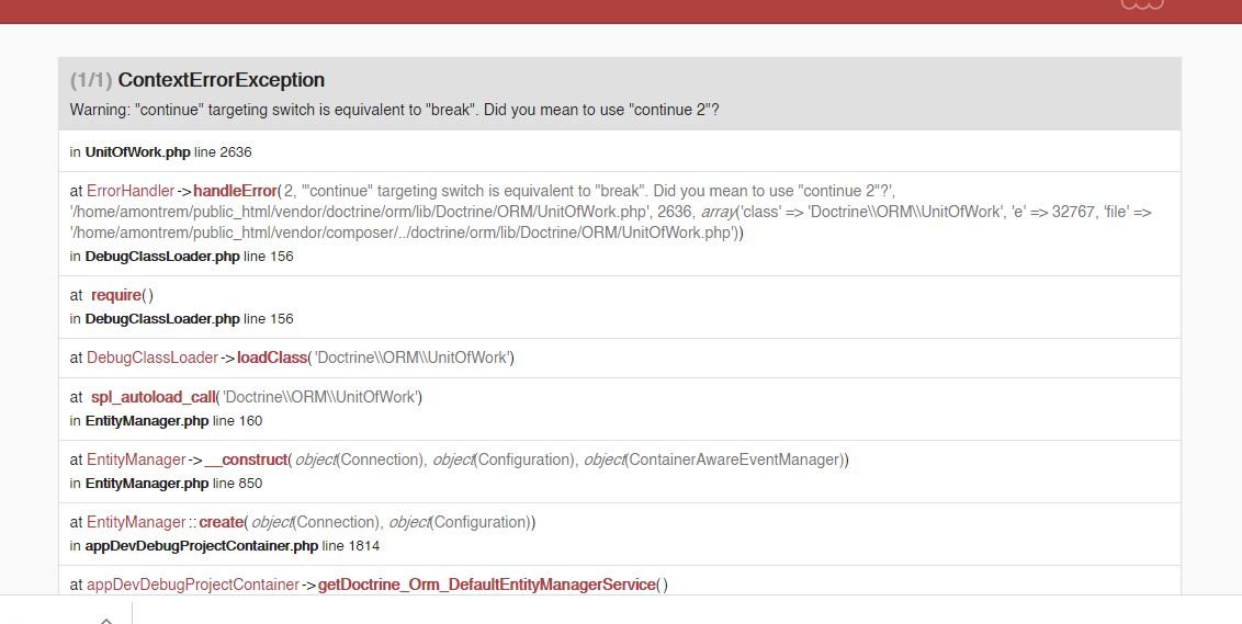

Daniel Patilea Posted December 4, 2016 Share Posted December 4, 2016 (edited) The debug mode is widely used to see the errors on your shop and when: you get blank pages; you get 500 Internal Server Error; you have strage issues with your shop and don't know where to start; Edit: Debug mode on PrestaShop 8.0 PrestaShop Dashboard > Advanced Parameters > Performance > DEBUG MODE PANEL > Set it to YES Debug mode on PrestaShop 1.7 PrestaShop Dashboard > Advanced Parameters > Performance > DEBUG MODE PANEL > Set it to YES To turn on the Debug mode on PrestaShop 1.7 is more simple comparing it to the previous versions of Prestashop. You can do this from your PrestaShop Dashboard > Advanced Parameters > Performance > DEBUG MODE PANEL > Set it to YES If you can't acces you dashboard you can also enable it through FTP by accessing config/defines.inc.php and usually @line 29 you will find: define('_PS_MODE_DEV_', false); change it to: define('_PS_MODE_DEV_', true); Turning on the Debug Mode on other versions of Prestashop Debug mode on PrestaShop 1.5.3 to 1.6 For PrestaShop 1.5.3 to 1.6 the procedure is the same: Open config/defines.inc.php and usually @line 29 you will find : define('_PS_MODE_DEV_', false); change it to: define('_PS_MODE_DEV_', true); For PrestaShop below 1.5.3 you have to edit the config/defines.inc.php file and make the following changes: Change this line: @ini_set('display_errors', 'off'); to this: @ini_set('display_errors', 'on'); !!! Be careful, turn the Debug Mode off when finished debugging, hackers may get advatage of it and may harm your website and besides of that any visible error is not good for visitors. Debug mode for Admin or specific IPs Because Debug mode should not be visible for your customers here's a smart solution that allows you to enable it only for admins or for some provided IPs. This way your shop will not be vulnerable while you debug. Edited May 2, 2023 by Daniel Patilea New version of PrestaShop (8.0) (see edit history) 8 4 Link to comment Share on other sites More sharing options...

Mexa Shop Posted November 19, 2019 Share Posted November 19, 2019 On 6/12/2019 at 11:59 AM, Daniel Patilea said: Usually the debug is displayed on your browser tab when there's an error. You can also view errors in error_log file from the root folder of your site. Expand On 6/12/2019 at 11:59 AM, Daniel Patilea said: Usually the debug is displayed on your browser tab when there's an error. You can also view errors in error_log file from the root folder of your site. Expand Hi Daniel, I've changed config/defines.inc.php from false to true, however, I do not see any difference when I try to access my backoffice or web page. the only message that i receive is : 500 Server Error Oops, something went wrong. Try to refresh this page or feel free to contact us if the problem persists. I´ve searched for the error_log inside the folder logs in filezilla, but there isn´t one any idea on how can I have more info about this Error 500 ? ----------------------------------------------------------- /* Debug only */ if (!defined('_PS_MODE_DEV_')) { define('_PS_MODE_DEV_', true); } Link to comment Share on other sites More sharing options...
Daniel Patilea Posted November 21, 2019 Author Share Posted November 21, 2019 On 11/19/2019 at 5:46 PM, Mexa Shop said: Hi Daniel, I've changed config/defines.inc.php from false to true, however, I do not see any difference when I try to access my backoffice or web page. the only message that i receive is : 500 Server Error Oops, something went wrong. Try to refresh this page or feel free to contact us if the problem persists. I´ve searched for the error_log inside the folder logs in filezilla, but there isn´t one any idea on how can I have more info about this Error 500 ? ----------------------------------------------------------- /* Debug only */ if (!defined('_PS_MODE_DEV_')) { define('_PS_MODE_DEV_', true); } Expand Check your files&folder permissions and also the .htaccess file. Link to comment Share on other sites More sharing options...
