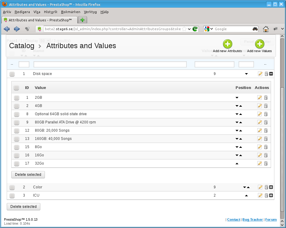

mrzoom Posted June 10, 2012 Share Posted June 10, 2012 I just wanted you to know that they have added attribute postion in prestashop 1.5. So you can drag attributes and groups around without any extra modules or code changes Link to comment Share on other sites More sharing options...
