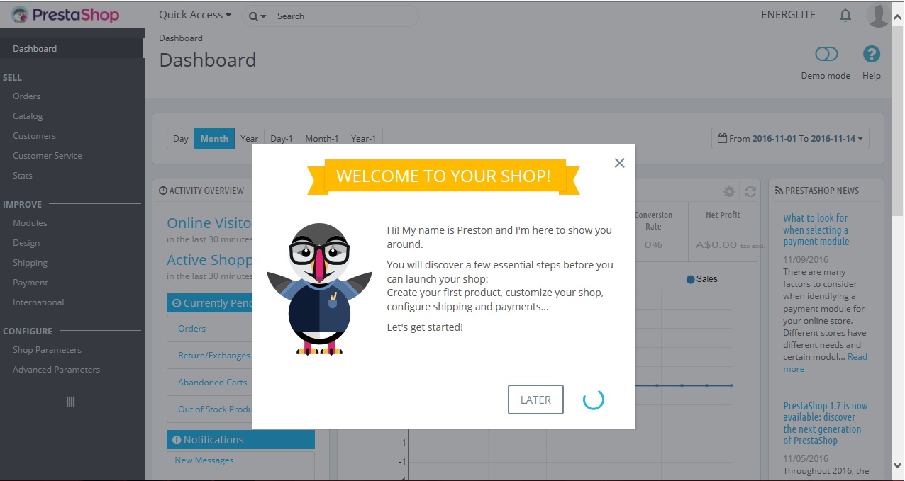

energlite Posted November 13, 2016 Share Posted November 13, 2016 (edited) I have a problem with Preston - he doesn't work and is in my way - Any Ideas Guys? (see attached Screen Print) Stalls when press start. Does nothing when press later. Does nothing when press X to close. FOUND A SOLUTION TO THE PROBLEM - Something to Note with any backend or front end problems. I have found that permissions need to be changed to 755 especially "index.php" files as nothing happens until they are changed from 644 or 666 to 755. In this particular case I had changed the files to enable the main and admin "index.php" file permissions to 755 which allowed the site to come out of a 500 error and be seen. However in Modules/Welcome there are also "index.php" files that I had to set to 755 to allow the welcome to your site Wizard with Preston to Operate. Whilst all folders are by default 755, it appears that files are having problems unless they too are set to 755 Edited November 14, 2016 by energlite (see edit history) Link to comment Share on other sites More sharing options...
ririfog Posted November 27, 2016 Share Posted November 27, 2016 Hi. I have the same problem, but your solution did not worked for me. I changed permission to all files to 777, but that f**ing Preston is still there! Any help is welcome... PS i'm using a VPS with dreamhost as hosting. Thanks Marco Link to comment Share on other sites More sharing options...
energlite Posted November 28, 2016 Author Share Posted November 28, 2016 I found that 777 doesn't work it has to be 755 and especially in the same folder as Preston is operating ...sorry forgot the folder he is located but should be esy enough to find with a search. Link to comment Share on other sites More sharing options...
