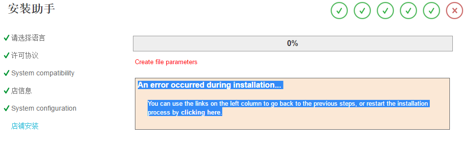

langziyang Posted November 8, 2016 Share Posted November 8, 2016 Create file parameters An error occurred during installation... You can use the links on the left column to go back to the previous steps, or restart the installation process by clicking here. 1 Link to comment Share on other sites More sharing options...

hubik.tomas Posted November 8, 2016 Share Posted November 8, 2016 Create file parameters An error occurred during installation... You can use the links on the left column to go back to the previous steps, or restart the installation process by clicking here. 1.png I am experiencing the same issue since RC2. Installation of RC1 worked without problems. Link to comment Share on other sites More sharing options...

dungvn1187 Posted November 9, 2016 Share Posted November 9, 2016 Create file parameters An error occurred during installation... You can use the links on the left column to go back to the previous steps, or restart the installation process by clicking here. 1.png I am also having the same issue. Link to comment Share on other sites More sharing options...

Andrej Stas Posted November 9, 2016 Share Posted November 9, 2016 Create file parameters An error occurred during installation... You can use the links on the left column to go back to the previous steps, or restart the installation process by clicking here. 1.png Same issue here. I could install RC3 Link to comment Share on other sites More sharing options...

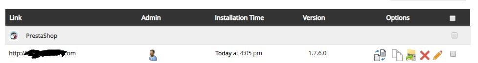

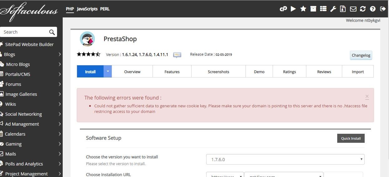

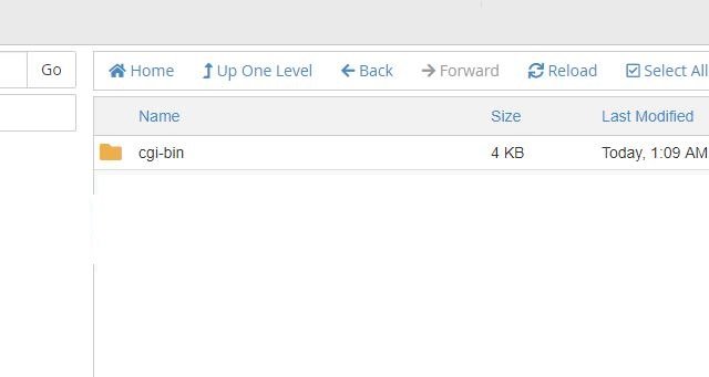

HamedAllawi Posted August 19, 2019 Share Posted August 19, 2019 I had the same issue but now it was fixed, I removed all unwanted files from the directory and only keeps one and the reinstalled it, it worked fine for me as shown below now it's installed Link to comment Share on other sites More sharing options...
