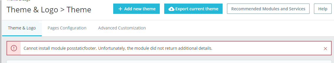

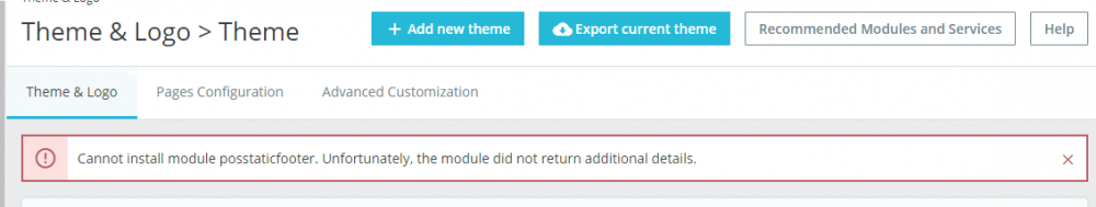

Muhammad Imran Posted July 18, 2020 Share Posted July 18, 2020 (edited) Today i installed theme purchased from themeforest and after activating the theme i got this message "Cannot install module posstaticfooter. Unfortunately, the module did not return additional details." I have latest version of Prestashop 1.7.6.7. Please any Solution? Edited July 18, 2020 by Muhammad Imran (see edit history) Link to comment Share on other sites More sharing options...
