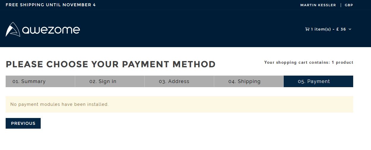

meikel Posted October 31, 2016 Share Posted October 31, 2016 Hello, In our shop our prices have been in EUROs and payment is possible with CreditCard. This worked fine so far.www.awezome.comWe have now added an additional currency (Britisch Pound). Unfortunately during Checkout process, after I confirm the T&C, I always get the message "No Payment modules have been installed. See screenshot attached.Do I need to set sth else up as well for an additional currency? Best regards Michael Link to comment Share on other sites More sharing options...

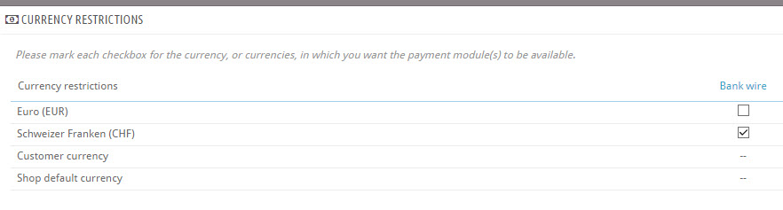

jetway Posted October 31, 2016 Share Posted October 31, 2016 (edited) Yes, you need to specify which payment options are available for the currency. At the moment there are none. Go to: Modules and Services -> Payment Scroll Down and select the payment options. Edited October 31, 2016 by jetway (see edit history) 2 Link to comment Share on other sites More sharing options...
meikel Posted October 31, 2016 Author Share Posted October 31, 2016 (edited) Hi Jetway, Thanks, that exactly what I have missed. Now it is working. Thank so much for your help. Best regards Mike Edited October 31, 2016 by meikel (see edit history) Link to comment Share on other sites More sharing options...
