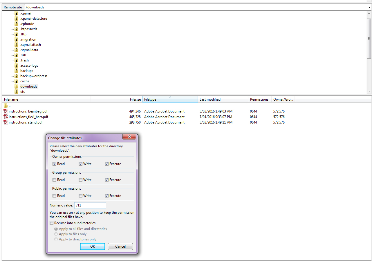

kinderyum Posted October 30, 2016 Author Share Posted October 30, 2016 I just checked and the downloads directory is the right place. Perhaps it's a permissions issue? Check to make sure the downloads directory is chmod 755. You can edit config/defines.inc.php and change the value of _PS_MODE_DEV_ from false to true to get a more specific error message than just 500 Internal Server Error. I'm not too familiar with permissions but when I right click on the downloads folder and click 'file attributes' this is what I get: Link to comment Share on other sites More sharing options...
rocky Posted October 30, 2016 Share Posted October 30, 2016 You can try ticking "Read" and "Write" under "Group permissions" to see if that helps. Link to comment Share on other sites More sharing options...
kinderyum Posted October 30, 2016 Author Share Posted October 30, 2016 You can try ticking "Read" and "Write" under "Group permissions" to see if that helps. OK thanks I will do that also. Is it safe to do so? Link to comment Share on other sites More sharing options...
rocky Posted October 30, 2016 Share Posted October 30, 2016 Yes, it's the "Public permissions" that are unsafe to change. 1 Link to comment Share on other sites More sharing options...

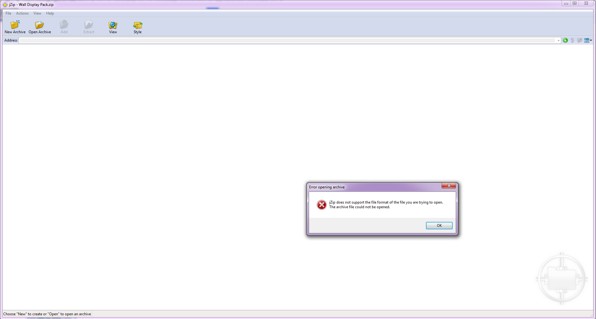

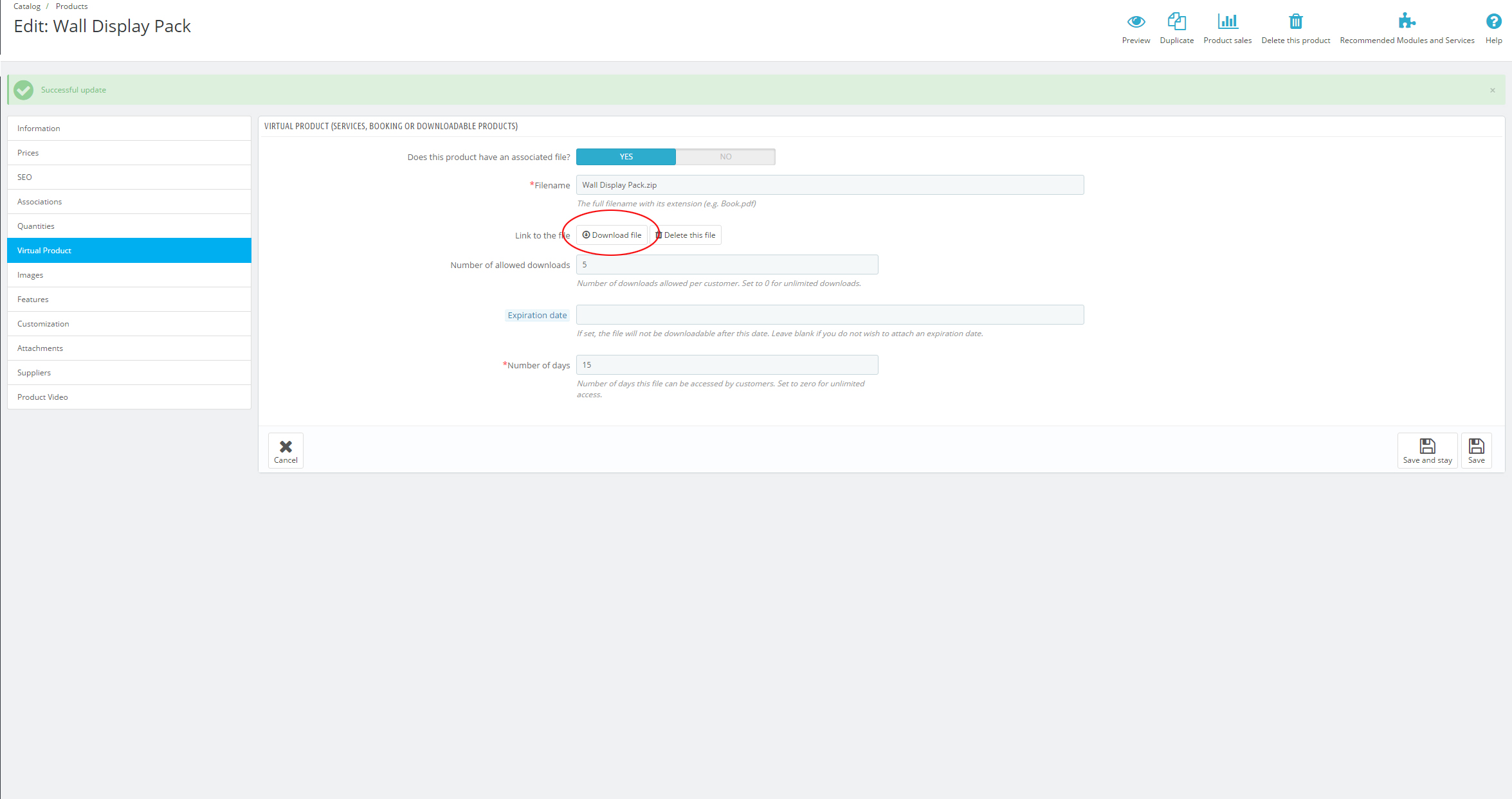

kinderyum Posted November 2, 2016 Author Share Posted November 2, 2016 (edited) Just replying to my own post lol but there is definitely something not working correctly with the 'rename method' (see HERE for the method). I uploaded the zipped file then downloaded it (both via FTP) BEFORE renaming to the long string of letters/numbers and it WORKED FINE. However when I rename it (to replace the small uploaded file) and then download it (from PS back end), it DOES NOT WORK. The unzipping program gives an error (file can not be opened). So, for me, there is no problem uploading the large file (through FTP), the problem is with downloading it correctly after renaming it (to the long auto-generated name) which in turns replaces the small file. Something is getting broken in this process. Hoping someone can shed some light on this frustrating issue for me. Edited November 3, 2016 by kinderyum (see edit history) Link to comment Share on other sites More sharing options...
