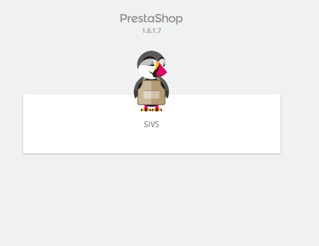

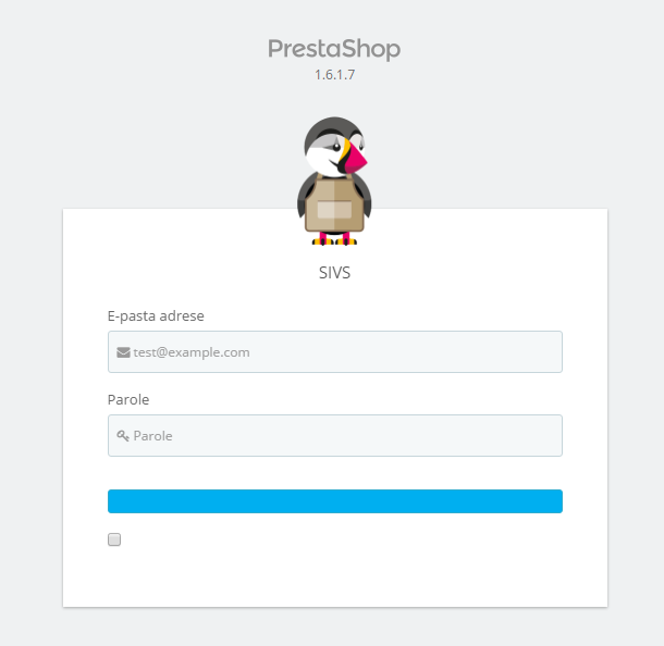

ticklv Posted October 24, 2016 Share Posted October 24, 2016 After i update prestashop version to 1.6.1.7. i can't access admin area. After i fill the form and press log-in it don't redirect to back-office. I cleared the cache, chech database if everything is ok with domain.. tried other PC and browser. Nothing helped. the form After i fill the form and press log-in it shows this page and nothing happens. Link to comment Share on other sites More sharing options...

mirelr Posted October 30, 2016 Share Posted October 30, 2016 Not translated log in your language. Browse to the file translations and replace LOG IN authentication in your language Link to comment Share on other sites More sharing options...
