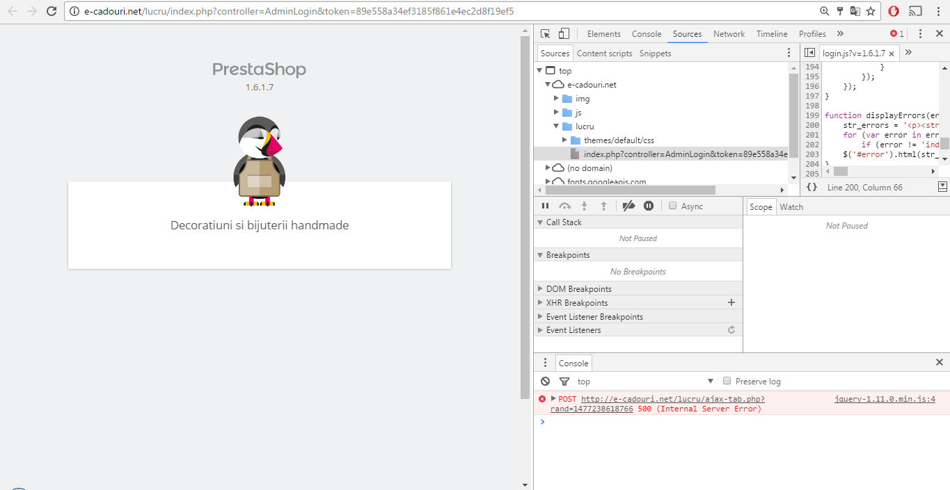

imugur Posted October 23, 2016 Share Posted October 23, 2016 (edited) I did an upgrade from 1.6.0.5 to 1.6.1.7. Everything finished OK without any errors. But when I want to login in Back office, after inserting the email and the password, nothing happens. In the browser console I get the following error message: jquery-1.11.0.min.js:4 POST http://e-cadouri.net/xxx/ajax-tab.php?rand=1477238081326 500 (Internal Server Error) I enabled debug logging, I cleared cache and cookies, I checked the cookie string, and all other posts on this forum related to this subject. Do you have any suggestions before I rollback? Fix is related to localization. The localized admin file found in translations/your language/admin.php. has missing translations most probably. Change it with default English file found in translations/en folder and should work Edited October 26, 2016 by imugur (see edit history) Link to comment Share on other sites More sharing options...

imugur Posted October 24, 2016 Author Share Posted October 24, 2016 you mean dev mode on Chrome? here it is what I get: jquery-1.11.0.min.js:4 POST http://e-cadouri.net/lucru/ajax-tab.php?rand=1477311712321 500 (Internal Server Error)send @ jquery-1.11.0.min.js:4ajax @ jquery-1.11.0.min.js:4(anonymous function) @ login.js?v=1.6.1.7:130d.complete @ jquery-1.11.0.min.js:4j @ jquery-1.11.0.min.js:2add @ jquery-1.11.0.min.js:2lc @ jquery-1.11.0.min.js:4g @ jquery-1.11.0.min.js:4dequeue @ jquery-1.11.0.min.js:3(anonymous function) @ jquery-1.11.0.min.js:3each @ jquery-1.11.0.min.js:2each @ jquery-1.11.0.min.js:2queue @ jquery-1.11.0.min.js:3animate @ jquery-1.11.0.min.js:4n.fn.(anonymous function) @ jquery-1.11.0.min.js:4doAjaxLogin @ login.js?v=1.6.1.7:129submitHandler @ login.js?v=1.6.1.7:14s @ jquery.validate.js:2(anonymous function) @ jquery.validate.js:2dispatch @ jquery-1.11.0.min.js:3r.handle @ jquery-1.11.0.min.js:3 not sure what this means... Link to comment Share on other sites More sharing options...
