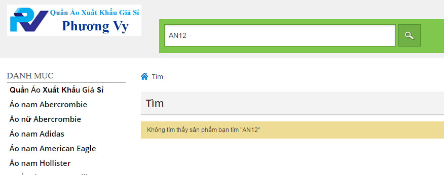

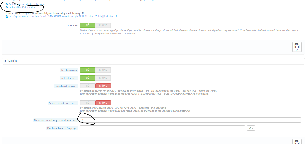

phuongvyhanghieu Posted October 23, 2016 Share Posted October 23, 2016 Experts please help me to solve this issue. My quick search box is not working. "No results were found for your search" after enter product names or reference codes. I tried to do the following steps but it is still not working. - Preferences --> Search --> Minimum word length (in characters)->change value 3 to 2 - Re-build the entire index PrestaShop™ 1.6.0.14 http://quanaoxuatkhausi.net/ Thank you very much in advance Link to comment Share on other sites More sharing options...

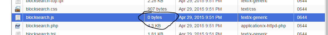

phuongvyhanghieu Posted October 24, 2016 Author Share Posted October 24, 2016 (edited) Hi Prestamonste, I checked the js search file and nothing in that file. Please see the attached file for detail. Thank you. Edited October 24, 2016 by phuongvyhanghieu (see edit history) Link to comment Share on other sites More sharing options...
prestamonste Posted October 24, 2016 Share Posted October 24, 2016 Hi, You can see it in here: your_website/themes/your_theme/js/modules/blocksearch/blocksearch.js Line code 39. Link to comment Share on other sites More sharing options...

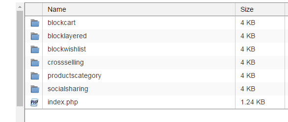

phuongvyhanghieu Posted October 25, 2016 Author Share Posted October 25, 2016 Hi Prestamonste, I followed your instruction, but no blocksearch found in the modules. your_website/themes/your_theme/js/modules/(blocksearch not found here). Thank you for your help. Link to comment Share on other sites More sharing options...
NemoPS Posted October 28, 2016 Share Posted October 28, 2016 Custom template? The original one is supposed to be empty, but the theme one is not, and it should actually be there. I doubt adding it will fix the issue though, it seems php related. Try disabling instant and ajax searches in the box anyway, just search by hitting enterDo you have any search class override in place? override/classes Link to comment Share on other sites More sharing options...
