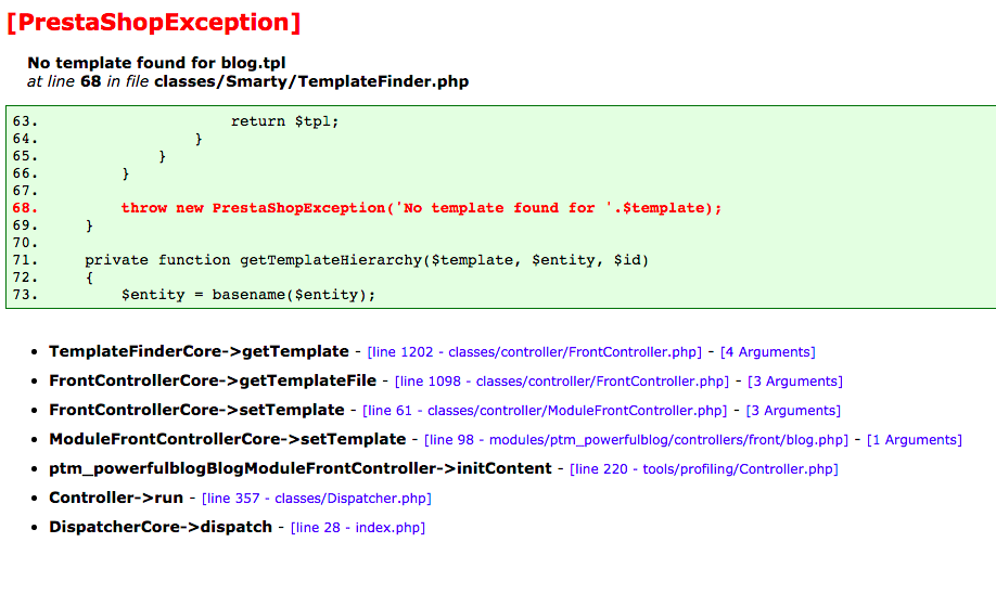

Andrej Stas Posted October 20, 2016 Share Posted October 20, 2016 (edited) We are developing Blog Module for Prestashop 1.7. This is our new problem now: in our_module/controllers/front/some_file.php we call $this->setTemplate('blog.tpl'); Blog.tpl really exists: our_module/views/templates/front/blog.tpl However, we are getting this error (see screenshot) This is working correctly in RC1, not working in RC2 EDIT: not working also in RC3 Edited October 30, 2016 by Andrej Stas (see edit history) 2 Link to comment Share on other sites More sharing options...

Andrej Stas Posted October 31, 2016 Author Share Posted October 31, 2016 You are right, it should be written as "blog" instead of "blog.tpl", but my problem still persists. I found out that Prestashop is always searching for this "blog.tpl" only in the "theme" folder. But in my case, the TPL files are saved in the module folder our_module/views/templates/front/blog.tpl Link to comment Share on other sites More sharing options...

Yoddle Posted November 4, 2016 Share Posted November 4, 2016 Hello! I got the same problem. setTemplate() tries to find the template file in the theme directory. More specifically, in "templates/fr-FR" (or "templates/en-EN", "templates/es-ES"... depend on the shop language). Are we supposed to use another function to load templates in 1.7? Link to comment Share on other sites More sharing options...

razaro Posted November 4, 2016 Share Posted November 4, 2016 Yes you are right my bad. In initContent() method maybe something like this $this->setTemplate('module:our_module/views/templates/front/blog.tpl'); Example also in https://github.com/PrestaShop/ps_emailsubscription/blob/master/controllers/front/verification.php#L50 And about languages not sure how it is for module but here is some info about template hierarchy, but as I understand for themes mostly. https://github.com/PrestaShop/PrestaShop/pull/5809 1 Link to comment Share on other sites More sharing options...
Yoddle Posted November 7, 2016 Share Posted November 7, 2016 (edited) I tried with a path like 'module:our_module/views/templates/front/blog.tpl' : It loads the template, but not the layout. I only got the template content, nothing else, no css, no js, not a single piece of the theme html. And I can't find any parameter for initContent or setTemplate that specify if we want just the template or the whole page. What am I doing wrong? Edited November 7, 2016 by Yoddle (see edit history) Link to comment Share on other sites More sharing options...
