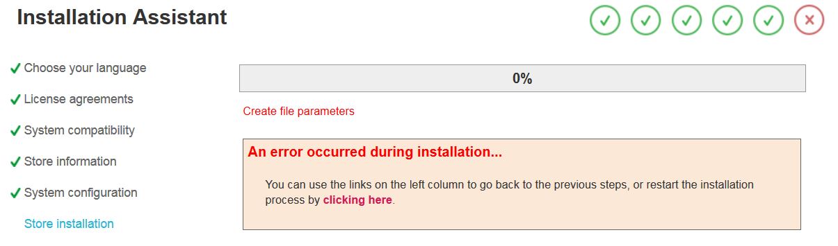

a_smith Posted October 17, 2016 Share Posted October 17, 2016 1700RC2, newly downloaded, installation failed on next step after the database connection. It says 'Create file parameters' in red and the installation proces stops. Dev mode is enabled but there is no log files in app/logs/ folder. How can I know what stops the installator? Link to comment Share on other sites More sharing options...

a_smith Posted October 18, 2016 Author Share Posted October 18, 2016 (edited) Small update. I,ve tried PHP 5.4, 5.5 and 5.6 on my Debian VPS. Problem stays same. The parameters.php file is not created on the server and the installation proces stops. I also tried previous RC1 version but it gives me same error. Edited October 18, 2016 by a_smith (see edit history) Link to comment Share on other sites More sharing options...

mik@ Posted October 31, 2016 Share Posted October 31, 2016 (edited) Same problem here with PHP 5.6.27 On my Plesk panel I got this log info: Apache Error AH01071: Got error 'PHP message: PHP Fatal error: Uncaught exception 'Defuse\\Crypto\\Exception\\EnvironmentIsBrokenException' with message 'Your system does not have a secure random number generator.' in /var/www/vhosts/mydomain.com/www/vendor/defuse/php-encryption/src/Core.php:110\nStack trace:\n#0 /var/www/vhosts/mydomain.com/www/vendor/defuse/php-encryption/src/Key.php(23): Defuse\\Crypto\\Core::secureRandom(32)\n#1 /var/www/vhosts/mydomain.com/www/classes/PhpEncryptionEngine.php(101): Defuse\\Crypto\\Key::createNewRandomKey()\n#2 /var/www/vhosts/mydomain.com/www/classes/PhpEncryption.php(97): PhpEncryptionEngineCore::createNewRandomKey()\n#3 /var/www/vhosts/mydomain.com/www/src/PrestaShopBundle/Install/Install.php(132): PhpEncryptionCore::createNewRandomKey()\n#4 /var/www/vhosts/mydomain.com/www/install/controllers/http/process.php(132): PrestaShopBundle\\Install\\Install->generateSettingsFile('127.0.0.1', 'xxxx', 'xxxx', 'test-17', 'ps_', 'InnoDB')\n#5 /var/www/vhos...\n', referer: http://www.mydomain.com/install/index.php This issue was in RC2 and RC3 After changing to PHP 7 installation is OK. Edited October 31, 2016 by mik@ (see edit history) Link to comment Share on other sites More sharing options...
Rhobur Posted November 1, 2016 Share Posted November 1, 2016 @a_smith, did you try with php 7? This solves the random generator issue. Link to comment Share on other sites More sharing options...

Antonino - Uebix.com Posted November 7, 2016 Share Posted November 7, 2016 The ZipArchive problem is note related to the random generator exception. The solution for random generator exception is to downgrade paragonie/random_compact library from 2.x to 1.4.x or switch php to 7.x version http://forge.prestashop.com/browse/BOOM-1773 Link to comment Share on other sites More sharing options...
