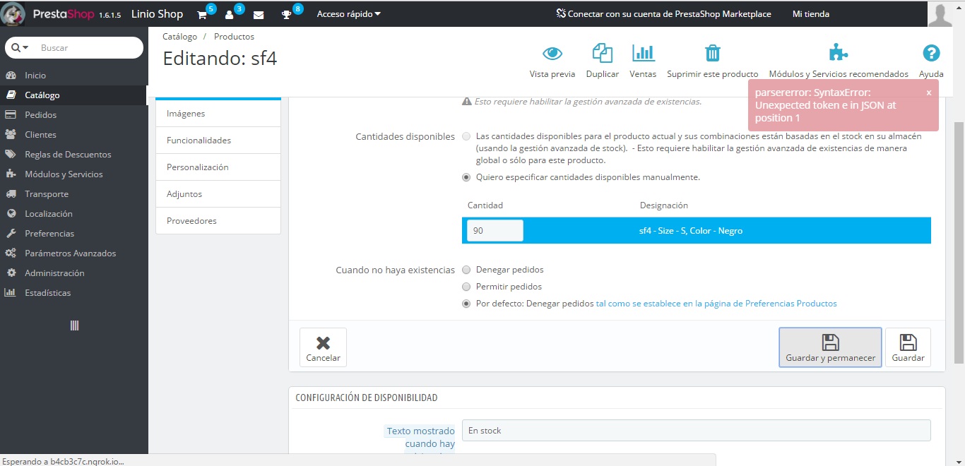

java2dev Posted October 18, 2016 Author Share Posted October 18, 2016 (edited) when I added die; and click on save I received a message error as in the picture "parser error: SyntaxError: Unexpected token e in JSON in position 1" but I have put it more at the end public function hookActionUpdateQuantity($params) { echo 'test1'; echo $params; if ($params['id_product_attribute']) { echo 'test2'; $idp = $params['id_product']; echo "el id_product is : $idp"; $ida = $params['id_product_attribute']; echo "el id_product_attribute is : $ida"; $api = new LinioApi(); $pr = new LinioProduct($idp, false, Context::getContext()->language->id); echo 'test3'; $sku = $pr->getSku($ida); $xml = simplexml_load_string($api->getProductBySku(array($sku))); echo 'test4'; $qty = (int) $xml->Body->Products->Product->Quantity; $res = (int) $xml->Body->Products->Product->ReservedStock; $avl = StockAvailable::getQuantityAvailableByProduct($idp, $ida); echo 'test5'; if (($qty - $res) < $avl) { echo 'test6'; $api->updateProduct($pr->getXmlQty($ida)); echo 'test7'; die; echo 'test8'; } echo 'test9'; } echo 'test10'; } but I have printed test1Arraytest10test1Arraytest2el id_product is : 2el id_product_attribute is : 7test3test4test5test6test7 Edited October 18, 2016 by java2dev (see edit history) Link to comment Share on other sites More sharing options...
