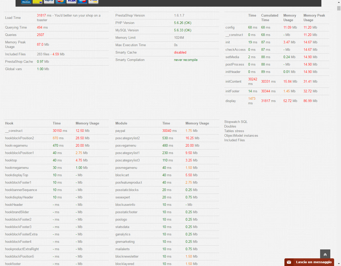

ietax Posted October 11, 2016 Share Posted October 11, 2016 (edited) About 2 days my site is very slow. This is report. Can anyone help me, thanks. Edited October 11, 2016 by ietax (see edit history) Link to comment Share on other sites More sharing options...
nadeo Posted October 11, 2016 Share Posted October 11, 2016 La dernière version du module PayPal est le problème, il doit être désactivé pour retrouver de bonnes performance. Puis remettre la version précédente en attendant un patch de PayPal. 1 Link to comment Share on other sites More sharing options...
ietax Posted October 11, 2016 Author Share Posted October 11, 2016 ou trouve-je la version precedente de paypal? merci Link to comment Share on other sites More sharing options...
bellini13 Posted October 11, 2016 Share Posted October 11, 2016 so much for using the English speaking forum. looks like your Paypal module is taking 30 seconds to perform some action. Did you recently update the paypal module? Link to comment Share on other sites More sharing options...
ietax Posted October 12, 2016 Author Share Posted October 12, 2016 (edited) yes, i have lastest version.. i will restore previous version. how can I set performance tab? thanks Edited October 12, 2016 by ietax (see edit history) Link to comment Share on other sites More sharing options...
Skin Thinks Posted October 12, 2016 Share Posted October 12, 2016 I have the same problem How I can get version 3.10 ?? ietax how you get that report? I would like to do in my shop to see load times! 1 Link to comment Share on other sites More sharing options...
Prestafan1234 Posted October 23, 2016 Share Posted October 23, 2016 In /config and the file defines.inc.php set this define('_PS_DEBUG_PROFILING_', false); to define('_PS_DEBUG_PROFILING_', true); Link to comment Share on other sites More sharing options...
Mister Denial Posted October 27, 2016 Share Posted October 27, 2016 so much for using the English speaking forum. looks like your Paypal module is taking 30 seconds to perform some action. Did you recently update the paypal module? For the sake of everyone understanding, they said that the latest version of PayPal module is causing the problem. Not sure which one is th latest though. I have 3.10.10 installed at the moment, and having huge slowness spikes. Basically, the site is super fast until an item is added to the basket, after that TTFB will increase to 7000-12000ms. Remove all items from cart, back to fast speed. I am updating to 1.6.1.7 and last version of PayPal module, let's see if that fixes the problem. Should I need an older version of PayPal module, how would I be able to locate it? Link to comment Share on other sites More sharing options...
